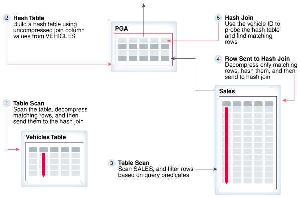

The following figure illustrates how the database joins the two data sets.
The database performs a hash join as follows:
Scans the
vehicles
table, decompresses the rows that satisfy the predicate (in this case, all rows satisfy the predicate because no filters exist), and sends the rows to the hash join -
Builds a hash table in the PGA based on the decompressed rows
Scans the
sales
table and applies any filters (in this case, the query does not specify filters) -
Processes matching rows from the IMCUs and then sends the rows to the join
When the hash join can consume row sets from the probe side (in this case, the
sales
table), the row sets sent by the table scan are in compressed form. Depending on whether the local dictionary or join group is leveraged to find matching rows from the build side, the hash join either decompresses the rows or leaves them uncompressed. -
Probes the hash table using the join column, which in this case is the vehicle name

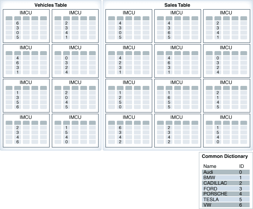

When a join group exists, the database stores codes for each join column value in a common dictionary. The database builds a join group array using dictionary codes. Every array element points to a build-side row stored in the hash area (typically, PGA memory). During the probe, each probe row has a code associated with the join key. The database uses this code to search the array to determine whether a pointer exists in the array element. If a pointer exists, then there is a match; otherwise, there is no match.
The dictionary codes are dense and have a fixed length, which makes them space efficient.
Optimizing a query with a join group is sometimes possible when it is not possible to use a Bloom filter.
How Join Groups Work
In a join group, the database compresses all columns in the join group using the same common dictionary.
How a Join Group Uses a Common Dictionary
A common dictionary is a table-level set of dictionary codes.
A common dictionary is instance-specific on single-instance Oracle databases and on Oracle RAC One Node databases. On an Oracle RAC cluster it is a global dictionary distributed across all nodes of the cluster.
The database automatically creates a common dictionary in the IM column store when a join group is defined on the underlying columns. The common dictionary enables the join columns to share the same dictionary codes.
A common dictionary provides the following benefits:
Encodes the values in the local dictionaries with codes from the common dictionary, which provides compression and increases the cache efficiency of the IMCU
Enables joins to use dictionary codes to construct and probe the data structures used during hash joins
Enables the optimizer to obtain statistics such as cardinality, distribution of column values, and so on
The following figure illustrates a common dictionary that corresponds to a join group created on the sales.name
and vehicles.name
columns.
Figure 8-2 Common Dictionary for a Join Group
Description of "Figure 8-2 Common Dictionary for a Join Group"
When the database uses a common dictionary, the local dictionary for each CU does not store the original values: AUDI
, BMW
, CADILLAC
, FORD
, and so on. Instead, the local dictionary stores references to the values stored in the common dictionary. For example, the local dictionary might store the value 101
for Audi
and 220
for BMW
. The common dictionary might store the value 0
for Audi
and 1
for BMW
. The 101
(AUDI) in the local dictionary is a pointer to the 0
(AUDI) in the common dictionary.

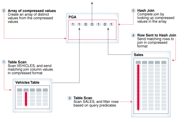

As illustrated in the preceding diagram, the database performs a hash join on the compressed data as follows:
Scans the
vehicles
table, and sends the dictionary codes (not the original column values) to the hash join:0
(Audi),1
(BMW),2
(Cadillac), and so on -
Builds an array of distinct common dictionary codes in the PGA
Scans the
sales
table and applies any filters (in this case, the filter is for German cars only) -
Sends matching rows to the join in compressed format
Looks up corresponding values in the array rather than probing a hash table, thus avoiding the need to compute a hash function on the join key columns

The database scans vehicles.name
, starting at the first dictionary code in the first IMCU and ending at the last code in the last IMCU. It stores a 1
for every row that matches the filter (German cars only), and 0
for every row that does not match the filter. Conceptually, the array might look as follows:
array[0]: 1
array[1]: 1
array[2]: 0
array[3]: 0
array[4]: 1
array[5]: 0
array[6]: 1
The database now scans the sales
fact table. To simplify the example, assume that the sales
table only has 6 rows. The database scans the rows as follows (the common dictionary code for each value is shown in parentheses):
Cadillac (2)
Cadillac (2)
BMW (1)
Ford (3)
Audi (0)
Tesla (5)
The database then proceeds through the vehicles.name
array, looking for matches. If a row matches, then the database sends the matching row with its associated common dictionary code, and retrieves the corresponding column value from the vehicles.name
and sales.name
IMCUs:
2 -> array[2] is 0, so no join
1 -> array[1] is 1, so join
3 -> array[3] is 0, so no join
0 -> array[0] is 1, so join
5 -> array[5] is 0, so no join

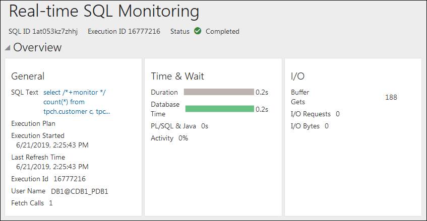

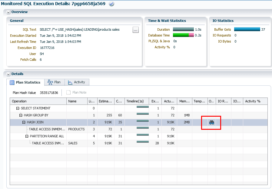

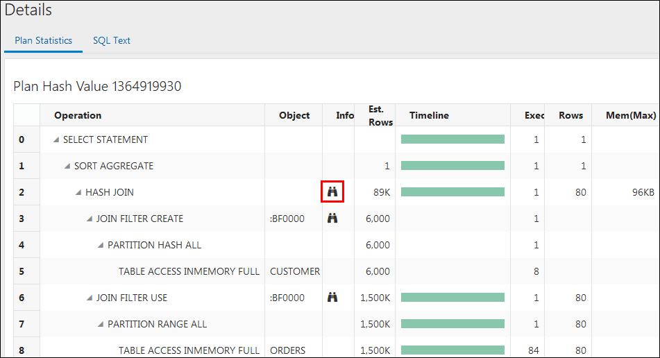

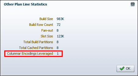

In a SQL Monitor report, the following fields show dictionary usage:
Columnar Encodings Observed
, and Columnar Encodings
Leveraged
. The statistics are cumulative. In a parallel hash join, the
fields summarize statistics collected from all child processes involved in executing a
row source. In the context of the local dictionary in an IMCU, the statistics show the
number of encoding IDs observed from the right child row source and the number of
encodings leveraged by the join. If a hash join on a single process leverages the common
dictionary, then Columnar Encodings Leveraged
shows the number of
encodings leveraged in the join.
The following table indicates the possible values for Columnar Encodings Observed
and Columnar Encodings Leveraged
, and what the combinations mean.
Table 8-1 Join Group Usage in a SQL Monitor Report
Columnar Encodings Observed | Columnar Encodings Leveraged | Encoding-Aware Hash Join Used? | Join Group-Aware Hash Join Used? |
Not present |
Not present |
No |
No |
Positive value |
Not present |
No |
No |
Positive value |
Positive value |
Yes |
No |
Not present |
Positive value |
No |
Yes |
For example, if the report shows that the Columnar Encodings Leveraged
field is 4
(for example, because the parallel degree is 4) but the Columnar Encodings Observed
field is absent, then the query leveraged the join group for the hash join. If the Columnar Encodings Observed
field is 4
but the Columnar Encodings Leveraged
field is absent, then dictionary encodings existed, but the query did not use them.

The following sample report shows the execution plan for the join. The binoculars in the hash join open a window that shows additional statistics.
Figure 8-4 Monitored SQL Execution Details Page
Description of "Figure 8-4 Monitored SQL Execution Details Page" -
Click the binoculars icon to open a window that shows join group statistics.
The following sample window shows the statistics:
Because
is a positive value andColumnar Encodings Observed
is not present, the join group was leveraged. -

The In-Memory vectorized joins feature is key to the deep vectorization framework. Using SIMD vector processing, the framework optimizes aspects of hash joins such as hashing, building, probing, and gathering. This optimization can improve the performance of join processing by 100% or more.
The In-Memory vectorized joins feature is transparent to the user, requiring no plan changes. The optimization is enabled by default, but you can disable it by setting the INMEMORY_DEEP_VECTORIZATION
initialization parameter to false
See Also:
"CPU Architecture: SIMD Vector Processing" to learn more about SIMD vectorization
Oracle AI Database SQL Tuning Guide to learn more about hash joins
How In-Memory Deep Vectorization Works
The In-Memory deep vectorization framework deconstructs high-level, complex SQL operators such as hash joins into smaller kernel-sized units.
The deconstructed kernels are suitable for SIMD vectorization techniques. The database executes the kernels in a pipelined fashion to accelerate the overall operation.
See Also:
How an In-Memory Vectorized Join Works
The vectorized joins feature is a key aspect of the In-Memory deep vectorization framework.
An In-Memory vectorized join works as follows:
At run time, the database decides whether a hash join would benefit from In-Memory deep vectorization. If so, the database proceeds to the next step.
Because selection of the vectorized joins operation occurs at runtime, the execution plan does not show the optimization.
The database pushes down join processing to the scan operators for evaluation directly on In-Memory columnar data formats.
The operation uses a SIMD-optimized hash table data structure instead of a traditional hash table.
The database determines matched rows from the left and right side of the join, and sends them back to the parent SQL operator using vectorization techniques.

You can use SQL Monitor to determine whether a query used a vectorized join. In a SQL Monitor report, click the binoculars icon next to the HASH JOIN
operation in the Information column. If DeepVec Hash Joins
has the value 1
, then the query used deep vectorization; otherwise, the query did not use it.

To create a SQL Monitor report in HTML, pass the SQL ID to
DBMS_SQL_MONITOR.REPORT_SQL_MONITOR
.See "Monitoring Join Group Usage" for an example showing how to generate the report.
Open the SQL Monitor report in a browser.
The overview section of the report appears below.
In the Details section of the report, find the
HASH JOIN
operation, and then click the binoculars icon. -
In the Other Information window, look for
DeepVec Hash Joins
. Because the value is1
, the database used an In-Memory vectorized join.Note that

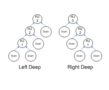

Types of Multi-Level Joins Supported by the Optimizer
There are two types of multi-level joins generated by the optimizer:
- Left Deep Joins
The result of each join node feeds the Build side of its parent join
- Right Deep Join
The result of each join node feeds the Probe side of its parent join
Description of the illustration inmem_multileveljoins.eps
