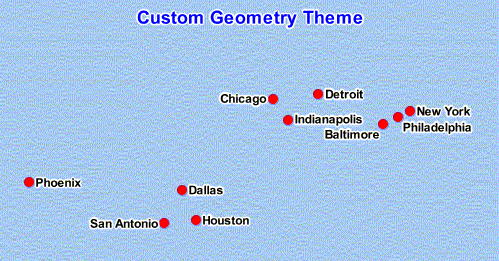

If the map visualization component can find the data file, the map request inExample C-2 should generate an image like the one in Figure C-1.
Figure C-1 Map Image Using Custom Geometry Theme and External Spatial Data
Description of "Figure C-1 Map Image Using Custom Geometry Theme and External Spatial Data"
