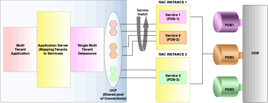

Single Multitenant Data Source Using Shared Pool
With this configuration, multiple tenants use the common data source and a common pool to serve connections with different services applicable to each of the tenants, as illustrated in the following diagram:
Figure 9-1 Single Multitenant Data Source Using Shared Pool
Description of Figure 9-1 follows
Description of "Figure 9-1 Single Multitenant Data Source Using Shared Pool"

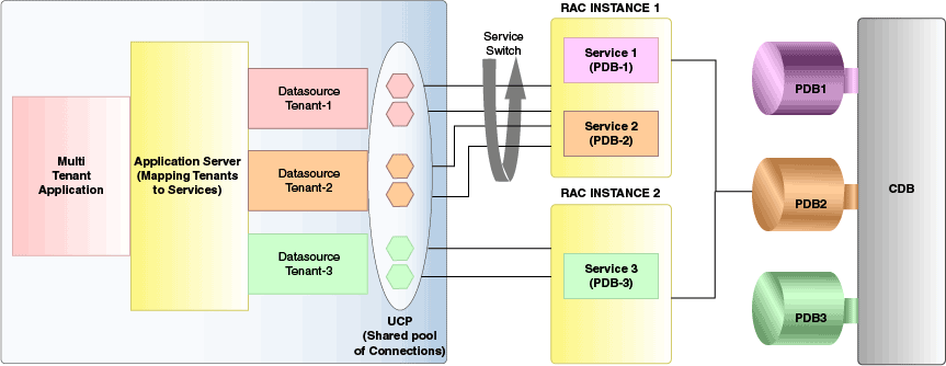

One Data Source per Tenant Using Shared Pool
With this configuration, multitenant applications have separate data sources per tenant and a common Shared Pool for connections. This results in the individual data sources being configured with tenant specific service information and sharing a common pool, as illustrated in the following diagram:
Figure 9-2 One Data Source per Tenant Using Shared Pool
Description of Figure 9-2 follows
Description of "Figure 9-2 One Data Source per Tenant Using Shared Pool"
