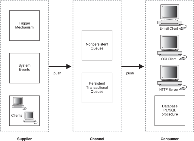

The publish-subscribe notification feature allows an OCI application to receive client notifications directly, register an email address to which notifications can be sent, register an HTTP URL to which notifications can be posted, or register a PL/SQL procedure to be invoked on a notification.
Figure 12-1 illustrates the process.
Figure 12-1 Publish-Subscribe Model
Description of Figure 12-1 follows
Description of "Figure 12-1 Publish-Subscribe Model"

Example 12-3 shows how system events, client notification, and Advanced Queuing work together to implement publish subscription notification.
The PL/SQL code in Example 12-3 creates all objects necessary to support a publish-subscribe mechanism under the user schema pubsub. In this code, the Agent snoop subscribes to messages that are published at logon events. Note that the user pubsub needs AQ_ADMINISTRATOR_ROLE and AQ_USER_ROLE privileges to use Advance Queuing functionality. The initialization parameter _SYSTEM_TRIG_ENABLED must be set to TRUE (the default) to enable triggers for system events. Connect as pubsub before running Example 12-3.
After the subscriptions are created, the client must register for notification using callback functions. Example 12-4 shows sample code that performs the necessary steps for registration. The initial steps of allocating and initializing session handles are omitted here for clarity.
If user IX logs on to the database, the client is notified by email, and the callback function notifySnoop is called. An email notification is sent to the address xyz@company.com and the PL/SQL procedure plsqlnotifySnoop is also called in the database.
