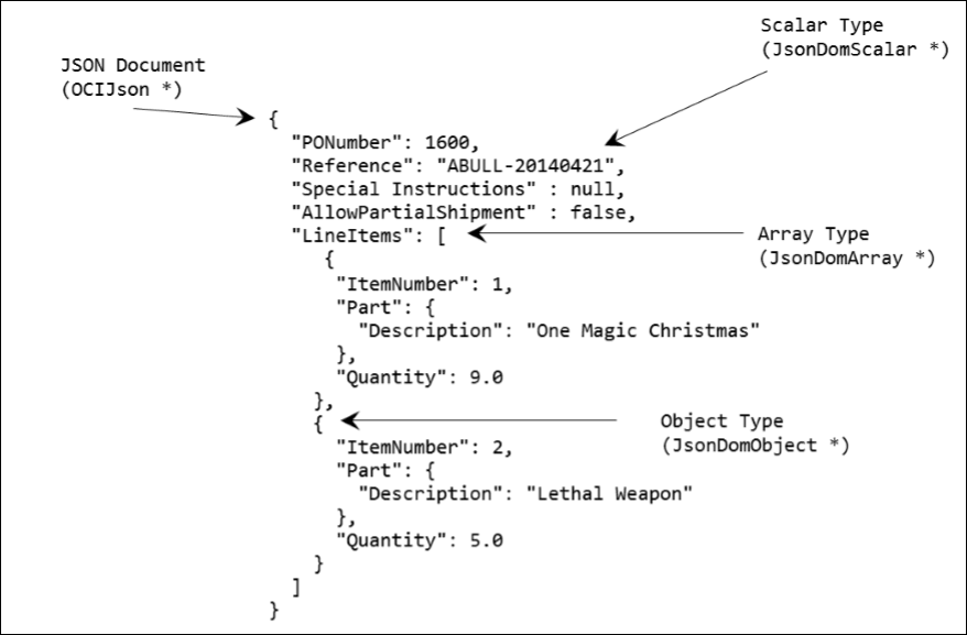

A sample JSON document structure is as shown in the following figure:
Figure 23-1 Sample JSON Document
Description of Figure 23-1 follows
Description of "Figure 23-1 Sample JSON Document"
You can use OCIJsonDomDocGet() function to obtain a reference to the underlying JSON DOM (Document Object Model) container represented by JsonDomDoc *. A JSON DOM document contains nodes that are either object, array, or scalar types.
Table 23-1 Type Constructs and Constants
Program Variable Type Constant
JsonDomScalar JZNDOM_SCALAR
JsonDomArray JZNDOM_ARRAY
JsonDomObject JZNDOM_OBJECT
JsonDomNode is an incomplete type. The type values listed in the preceding table can be set to (JsonDomNode *) type.
