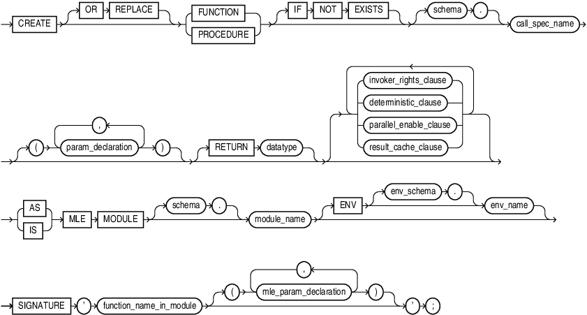

Creating a Call Specification for an MLE Module
MLE call specification creation uses the
generic CREATE FUNCTION RETURNS AS or CREATE PROCEDURE AS
syntax, followed by MLE specific syntax.

Topics
- Components of an MLE Call Specification
The elements of an MLE call specification are listed along with descriptions. - MLE Module Clause
TheMLE MODULEclause specifies the MLE module that exports the underlying JavaScript function for the call specification. The specified module must always be in the same schema as the call specification being created. - ENV Clause
The optionalENVclause specifies the MLE environment for module contexts in which this call specification will be executed. - SIGNATURE Clause
TheSIGNATUREclause contains all the information necessary to map the MLE call specification to a particular function exported by the specified MLE module.
Parent topic: Call Specifications for Functions
Table 6-1 Components of an MLE Call Specification
| Element Name | Description |
OR REPLACE |
Specifies that the function should be replaced if it already exists. This clause can be used to change the definition of an existing function without dropping, recreating, and re-granting object privileges previously granted on the function. Users who had previously been granted privileges on a recreated function or procedure can still access the function without being re-granted the privileges. |
IF NOT EXISTS |
Specifies that the function should be created if it does not already exist. If a function by the same name does exist, the statement is ignored without error and the original function body remains unchanged. Note that SQL*Plus will display the same output message regardless of whether the command is ignored or executed, ensuring that your DDL scripts remain idempotent.
schema |
Specifies the schema that will contain the call specification. If the schema is omitted, the call specification is created in the schema of the current user. |
call_spec_name |
Specifies the name of the call specification to be created. Call specifications are created in the default namespace, unlike MLE modules and environments, which use dedicated namespaces. |
param_declaration |
Specifies the call specification's parameters. If no parameters are specified, parentheses must be omitted. |
RETURN datatype |
Only used for functions and specifies the data type of the return value of the function. The return value can have any data type supported by MLE. Only the data type is specified; length, precision, or scale information must be omitted. |
invoker_rights_clause |
Specifies whether a function is invoker's or definer's rights.
If the |
deterministic_clause |
Only used for functions and indicates that the function returns the same result value whenever it is called with the same values for its parameters. As with PL/SQL functions, this clause should not be used for functions that access the database in any way that might affect the return result of the function. The results of doing so will not be captured if the database chooses not to re-execute the function. |

SIGNATURE Clause
The SIGNATURE clause contains all the information necessary
module.
Specifically, it includes two pieces of information:
- The name of the exported function in the specified MLE module.
- The MLE language parameter types (as opposed to the PL/SQL parameter types) for the function (Optional).
The SIGNATURE clause must be in the following form:
The path specification describes the function to be called and can have the following two forms:
A path specification can consist only of an import specification.
An import specification can be a JavaScript identifier that identifies a named export of the module, which must be a function. Alternatively, an import specification can be the reserved word,
default. In this case, the default export of the module is used, which must be a function.
A path specification can be a composite form consisting of an import specification, followed by a dot and a JavaScript identifier.
In this case, the import specification must refer to an object that has a property whose name matches the identifier listed after the dot. The value of the property needs to be a function.
