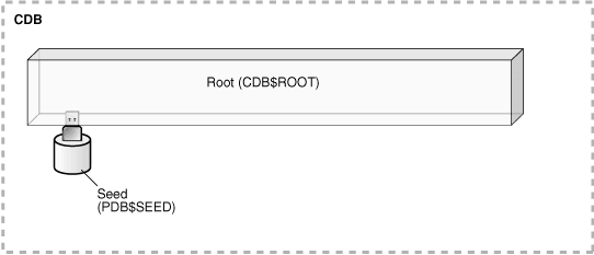

After Creating a CDB
After creation, a CDB consists of the root and the PDB seed.
The root contains system-supplied metadata and common users that can administer the PDBs. The PDB seed is a template that you can use to create new PDBs. The following graphic shows a newly created CDB.
In a CDB, the root contains minimal user data or no user data. User data resides in the PDBs. Therefore, after creating a CDB, one of the first tasks is to add the PDBs that will contain the user data.

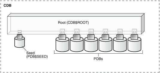

The following graphic shows a CDB with PDBs.
You have the option of creating one or more application containers. An application container consists of an application root and application PDBs, and it stores data for one or more applications. An application container can store application common objects, which contain user data that can be shared by the application PDBs in the application container. It can also contain an application seed for fast creation of application PDBs in an application container.
Figure 3-3 Application Containers in a CDB
Description of "Figure 3-3 Application Containers in a CDB"

This example includes the ENABLE PLUGGABLE DATABASE clause to create a CDB with the root and the PDB seed. This example also includes the SEED FILE_NAME_CONVERT clause to specify the names and locations of the PDB seed's files. This example also includes tablespace_datafile clauses that specify attributes of the PDB seed data files for the SYSTEM and SYSAUX tablespaces that differ from the root data files. This example includes the undo_mode_clause to specify that the CDB undo mode is local.

ENABLE PLUGGABLE DATABASEclause creates a CDB with the root and the PDB seed. -
SEEDis required for theFILE_NAME_CONVERTclause and thetablespace_datafileclauses. -

The CDB is named
newcdb. Its global database name isnewcdb.us.example.com, where the domain portion (us.example.com) is taken from the initialization parameter file. See Oracle AI Database Administrator’s Guide for information about determining the global database name. -
The passwords for user accounts
SYSandSYSTEMare set to the values that you specified. The passwords are case-sensitive. The two clauses that specify the passwords forSYSandSYSTEMare not mandatory in this release of Oracle Database. However, if you specify either clause, then you must specify both clauses. For further information about the use of these clauses, see Oracle AI Database Administrator’s Guide for information about specifying passwords for usersSYSandSYSTEM. -
The
DEFAULT TABLESPACEclause creates and names a default tablespace for this CDB. -
The
DEFAULT TEMPORARY TABLESPACEclause creates and names a default temporary tablespace for the root of this CDB. See Oracle AI Database Administrator’s Guide for information about creating a default temporary tablespace. -
The
UNDO TABLESPACEclause creates and names an undo tablespace that is used to store undo data for this CDB. In a CDB, an undo tablespace is required to manage the undo data, and theUNDO_MANAGEMENTinitialization parameter must be set toAUTO. If you omit this parameter, then it defaults toAUTO. See Oracle AI Database Administrator’s Guide for information about creating an undo tablespace. -
Redo log files will not initially be archived, because the
ARCHIVELOGclause is not specified in thisCREATE DATABASEstatement. This is customary during CDB creation. You can later use anALTER DATABASEstatement to switch toARCHIVELOGmode. The initialization parameters in the initialization parameter file fornewcdbrelating to archiving areLOG_ARCHIVE_DEST_1andLOG_ARCHIVE_FORMAT. See Oracle AI Database Administrator’s Guide for information about managing archived redo log files. -
The
ENABLE PLUGGABLE DATABASE SEEDclause is required for thetablespace_datafileclauses.Note:
If you do not specify the
SYSTEMandSYSAUXclauses, which are optional, then theENABLE PLUGGABLE DATABASE SEEDclause is not required. -
The
SYSTEM DATAFILESclause specifies attributes of the PDB seed'sSYSTEMtablespace data files that differ from the root's. -
The
SYSAUX DATAFILESclause specifies attributes of the PDB seed'sSYSAUXtablespace data files that differ from the root's.
