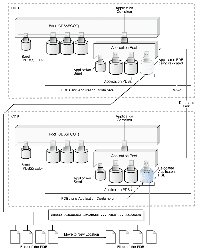

When the target PDB is an application PDB or application root, you have the following options:
  • You can relocate a PDB into an application container as an application PDB. The target PDB can be in the same CDB or a different CDB.
  • You can relocate an application PDB from one application root to another. The target PDB must be in a different CDB.
  • You can relocate an empty application root from one CDB to another, but the application root must not have any hosted application PDBs.
The following graphic illustrates how this technique creates a new application PDB in an application container.
Figure 9-2 Relocate a PDB into an Application Container
Description of Figure 9-2 follows
Description of "Figure 9-2 Relocate a PDB into an Application Container"
