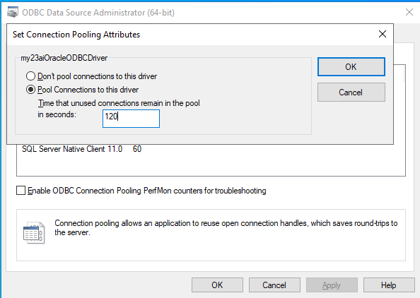

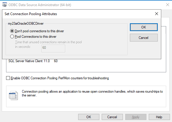

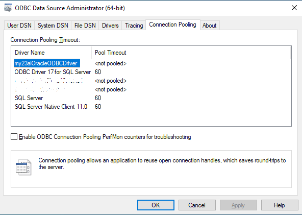

Enable connection pooling if the application frequently connects to and disconnects from a data source. Reusing pooled connections is extremely efficient compared to reestablishing a connection.

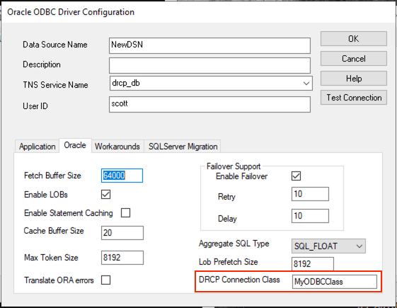

Enable Result Sets
This option enables the support of returning result sets (for example, RefCursor) from procedure calls. The default is enabling the returning of result sets.
The ODBC driver must query the database server to determine the set of parameters for
a procedure and their data types to determine if there are any
RefCursor parameters. This query incurs an additional network
round trip the first time any procedure is prepared and executed.
Enable LOBs
This option enables the support of inserting and updating LOBs. By default, it is enabled.
The ODBC driver must query the database server to determine the data types of each
parameter in an INSERT or UPDATE statement to
determine if there are any LOB parameters. This query incurs an additional network
round trip the first time any INSERT or UPDATE is
Bind TIMESTAMP as DATE
Binds SQL_TIMESTAMP parameters as the appropriate Oracle data type. If this option is TRUE, SQL_TIMESTAMP binds as the Oracle DATE data type. If this option is FALSE, SQL_TIMESTAMP binds as the Oracle TIMESTAMP data type (which is the default).
Enable Closing Cursors
The SQL_CLOSE option of the ODBC function, SQLFreeStmt, is supposed to close associated cursors with a statement and discard all pending results. The application can reopen the cursor by executing the statement again without doing a SQLPrepare again. A typical scenario for this is an application that is idle for a while but reuses the same SQL statement. While the application is idle, it might free up associated server resources.
The Oracle Call Interface (OCI), on which the Oracle Database ODBC driver is
layered, does not support the functionality of closing cursors. So, by default, the
SQL_CLOSE option has no effect in the Oracle Database ODBC
driver. The cursor and associated resources remain open on the database server.
Enabling this option causes the associated cursor to be closed on the database
server. However, this results in the parse context of the SQL statement being lost.
The ODBC application can execute the statement again without calling
SQLPrepare. However, internally the ODBC driver must prepare
and execute the statement all over. Enabling this option severely impacts
performance of applications that prepare a statement once and execute it
repeatedly.
Enable this option only if freeing the resources on the server is absolutely necessary.
Enable Thread Safety
If an application is single-threaded, this option can be disabled. By default, the ODBC driver ensures that access to all internal structures (environment, connection, statement) are thread-safe. Single-threaded applications can eliminate some of the thread safety overhead by disabling this option. Disabling this option typically shows a minor performance improvement.
Fetch Buffer Size
Set the Fetch Buffer Size in the Oracle Options tab of the Oracle ODBC Driver Configuration Dialog Box to a value specified in bytes. This value determines how many rows of data at a time the ODBC driver prefetches from an Oracle Database to the client's cache, regardless of the number of rows the application program requests in a single query, thus improving performance.
Applications that typically fetch fewer than 20 rows of data at a time improve their response time, particularly over slow network connections or on heavily loaded servers. Setting this too high can worsen response time or consume large amounts of memory. The default is 64,000 bytes. Choose a value that works best for your application.
When LONG and LOB data types are present, the number of rows
prefetched by the ODBC driver is not determined by the Fetch Buffer Size. The
inclusion of the LONG and LOB data types minimizes the
performance improvement and could result in excessive memory use. The ODBC
driver disregards the Fetch Buffer Size and prefetches a set number of rows in
the presence of the LONG and LOB data types.
