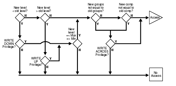

10.2.6.3 LABEL_UPDATE: Changing Data Labels
A user updating a row can normally change its label to any label within their authorized label range.
However, if LABEL_UPDATE applies, then to modify a label, the user must have one or more of these privileges: WRITEUP, WRITEDOWN, and WRITEACROSS.
The LABEL_UPDATE option uses an Oracle after-row trigger which is called only on an update operation affecting the label. Note that any labeling function in force on a table overrides the LABEL_UPDATE option.
Related Topics
Parent topic: Label Management Enforcement

When you attempt to update data based on your authorizations, the outcome depends on which enforcement controls are active.
If
UPDATE_CONTROLis active, then you can only update rows whose labels fall within your write authorizations. If you attempt to update data that you can read, but for which you do not have write authorization, then an error is raised. Assume, for example, that you can read compartments A and B, but you can only write to compartment A. In this case, if you attempt to update data with compartment B, then the statement will fail. -
If
UPDATE_CONTROLis not active, then you can update all rows to which you have read access. -
If
LABEL_UPDATEis active, then you must have the appropriate privilege (WRITEUP,WRITEDOWN, orWRITEACROSS) to change a label by raising or lowering its sensitivity level, or altering its groups or compartments. -
If
LABEL_UPDATEis not active butUPDATE_CONTROLis active, then you can update a label to any new label value within your write authorization. -
If
CHECK_CONTROLis active, then you can only write labels you are authorized to read.
The following figure illustrates the label evaluation process for LABEL_UPDATE.
Figure 10-1 Label Evaluation Process for LABEL_UPDATE
Description of "Figure 10-1 Label Evaluation Process for LABEL_UPDATE"
