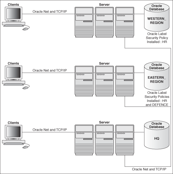

12.1 About the Oracle Label Security Distributed Configuration
In a network configuration that supports distributed databases, multiple Oracle Database (or other) servers can run on the same or different operating systems.
Each cooperative server in a distributed system communicates with other clients and servers over a network.
Figure 12-1 illustrates a distributed database that includes clients and servers with and without Oracle Label Security. As described in this chapter, if you establish database links from the WESTERN_REGION
database to the EASTERN_REGION
database, then you can access data if your user ID on EASTERN_REGION
is authorized to see it, even if locally (on WESTERN_REGION
) you do not have this access.
Figure 12-1 Using Oracle Label Security with a Distributed Database
Description of "Figure 12-1 Using Oracle Label Security with a Distributed Database"

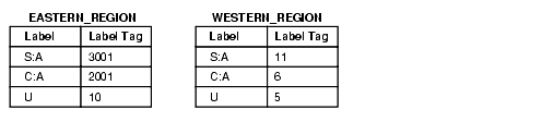

12.4.1 Label Tags in a Distributed Environment
In a distributed environment, you may choose to use the same label tags across multiple databases.
However, if you choose not to use the same tags across multiple databases, then you should retrieve the character form of the label when performing remote operations. This will ensure that the labels are consistent.
In the following example, the character string representation of the label string is the same. However, the label tag does not match. If the retrieved label tag has a value of 11
on the WESTERN_REGION
database but a tag of 2001
on the EASTERN_REGION
database, then the tags have no meaning. Serious consequences can result.
Figure 12-2 Label Tags in a Distributed Database
Description of "Figure 12-2 Label Tags in a Distributed Database"
When retrieving labels from a remote system, you should return the character string representation (rather than the numeric label tag), unless you are using the same numeric labels on both databases.
If you allow Oracle Label Security to automatically generate labels on different databases, then the label tags will not be identical. Character strings will have meaning, but the numeric values will not, unless you have predefined labels with the same label tags on both instances.
To avoid the complexities of label tags, you can convert labels to strings on retrieval (using LABEL_TO_CHAR
) and use CHAR_TO_LABEL
when you store labels. Operations will succeed as long as the component names are the same.
Parent topic: Labels in a Distributed Environment

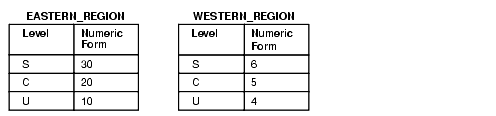

12.4.2 Numeric Form of Label Components in a Distributed Environment
In a distributed environment, the same relative ranking of the numeric form of the level component ensures that the labels are properly sorted.
In the following example, the levels in the two databases are effectively the same. Although the numeric form is different, the relative ranking of the levels numeric form is the same. As long as the relative order of the components is the same, the labels are perceived as identical.
Figure 12-3 Label Components in a Distributed Database
Description of "Figure 12-3 Label Components in a Distributed Database"

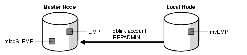

12.6.1.1 Replication Functionality Supported by Oracle Label Security
Oracle Label Security supports replication using read-only materialized views (snapshots).
Oracle Database uses materialized views for replicating data. A materialized view is a local copy of a local or remote master table that reflects a recent state of the master table.
As illustrated in the following figure, a master table is a table you wish to replicate, on a node that you designate as the master node. Using a dblink
account, you can create a materialized view of the table in a different database. (This can also be done in the same database, and on the same system.) You can select rows from the remote master table, and copy them into the local materialized view. Here, mvEMP
represents the materialized view of table EMP
, and mlog$_EMP
represents the materialized view log.
Figure 12-4 Use of Materialized Views for Replication
Description of "Figure 12-4 Use of Materialized Views for Replication"

12.6.3.1 Requirements for a Replication Administrator
Requirements for a replication administrator, typically using a REPADMIN
account, vary depending on the configuration.
In general, however, it should meet the following requirements:
It must have the
FULL
Oracle Label Security privilege (mandatory for all configurations). -
It must have the
SELECT
privilege on the master table. -
It must be the account that establishes the database link from the remote node to the database containing the master table.
