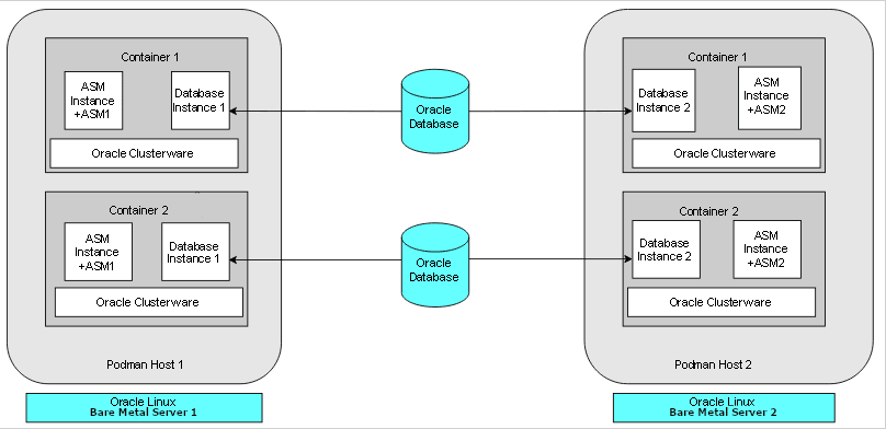

To prevent a single host causing complete downtime in a production environment, distribute Oracle RAC nodes across Podman hosts running on different physical servers. It is possible to configure Oracle RAC on Podman hosts running on same physical server for test and development environments.
The following figure shows a production configuration, in which there are two containers configured inside separate guest domains on one BM server, and two containers on a second BM server, also configured inside separate guest domains, with a high availability storage and network configuration:

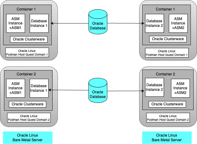

The following figure shows another production deployment, in which containers are located in different Podman hosts on separate hardware servers. Each bare metal server has two containers.

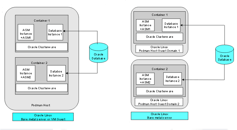

The following figure shows two examples of typical test and development deployments. The example on the left side shows a Podman host in which the cluster member nodes are containers in the same Podman host. The example on the right shows two Podman hosts on the same hardware server, with separate containers on each host.
For virtual test and development clusters, you can use two or more Podman containers as nodes of the same cluster, running on only one Oracle Linux Podman host, because high availability is not required for testing.
