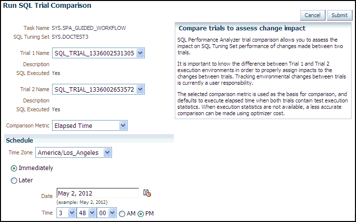

  1. On the Guided Workflow page, click the Execute icon for Compare Step 2 and Step 3.
    The Run SQL Trial Comparison page appears.
    In this example, the SQL_TRIAL_1241213421833 and SQL_TRIAL_1241213881923 trials are selected for comparison.
  2. To compare trials other than those listed by default, select the desired trials in the Trial 1 Name and Trial 2 Name lists.
    Note that you cannot compare a statistical trial with a trial that tests the explain plan only.
  3. In the Comparison Metric list, select the comparison metric to use for the comparison analysis:
    • Elapsed Time
    • CPU Time
    • User I/O Time
    • Buffer Gets
    • Physical I/O
    • Optimizer Cost
    • I/O Interconnect Bytes
    Optimizer Cost is the only comparison metric available if you generated execution plans only in the SQL trials.
    To perform the comparison analysis by using more than one comparison metric, perform separate comparison analyses by repeating this procedure with different metrics.
  4. In the Schedule section:
    1. In the Time Zone list, select your time zone code.
    2. Select Immediately to start the task now, or Later to schedule the task to start at a time specified using the Date and Time fields.
  5. Click Submit.
    The Guided Workflow page appears when the comparison analysis begins.
    The status icon of this step changes to an arrow icon while the comparison analysis is in progress. To refresh the status icon, click Refresh. Depending on the amount of performance data collected from the pre-change and post-change executions, the comparison analysis may take a long time to complete. After the comparison analysis is completed, the Status icon changes to a check mark and the Execute icon for the next step is enabled.

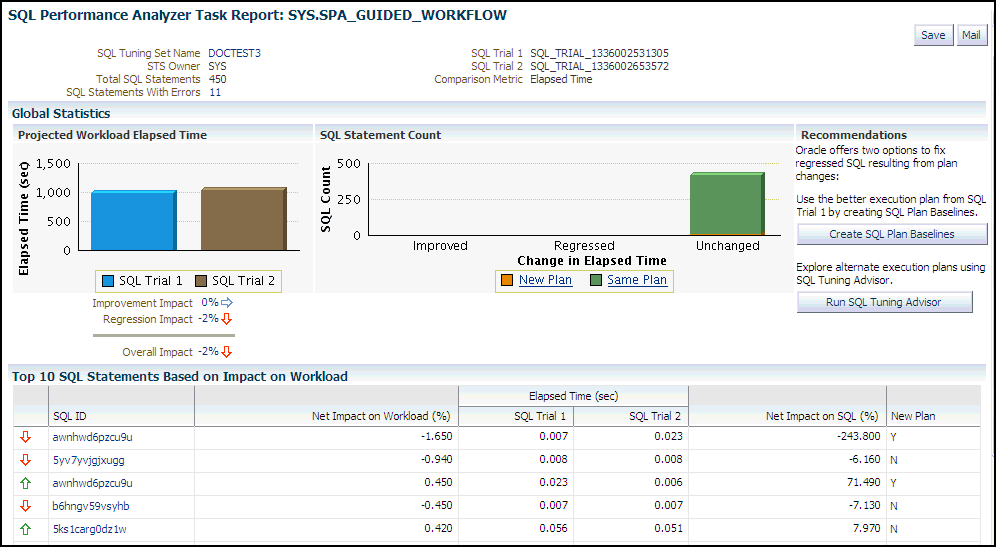

When a SQL Performance Analyzer task is completed, the resulting data is generated into a SQL Performance Analyzer report that compares the pre-change and post-change SQL performance.
Figure 6-1 shows a sample SQL Performance Analyzer report. This sample report uses the elapsed time comparison metric to compare the pre-change and post-change executions of a SQL workload.
Figure 6-1 SQL Performance Analyzer Report
Description of Figure 6-1 follows
Description of "Figure 6-1 SQL Performance Analyzer Report"

Reviewing the SQL Performance Analyzer Report: Global Statistics
The Global Statistics section reports statistics that describe the overall performance of the entire SQL workload. This section is a very important part of the SQL Performance Analyzer analysis, because it reports on the impact of the system change on the overall performance of the SQL workload. Use the information in this section to understand the tendency of the workload performance, and determine how it will be affected by the system change.
To review global statistics:
  1. Review the chart in the Projected Workload Elapsed Time subsection.
    The name of the subsection may vary based on the comparison metric that is selected.
    The chart shows the two trials on the x-axis and the elapsed time (in seconds) on the y-axis.
    The most important statistic is the overall impact, which is given as a percentage. The overall impact is the difference between the improvement impact and the regression impact. You can click the link for any impact statistic to obtain more details, as described in "Reviewing the SQL Performance Analyzer Report: Global Statistics Details".
    In this example, the improvement impact is 20%, while the regression impact is -2%, so the overall impact of the system change is an improvement of approximately 18%. This means that if all regressions are fixed in this example, the overall impact of the change will be an improvement of 20%.
    The overall impact percentage may sometimes be off by 1% compared to the sum of the improvement impact and the regression impact. This discrepancy may be caused by rounding or if the SQL and workload time limits are set at 1%, which is the recommended value. This enables the analysis to focus on SQL statements with higher impact by filtering out those that have a minimal impact.

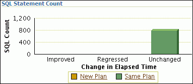

  2. Review the chart in the SQL Statement Count subsection.
    The x-axis of the chart shows the number of SQL statements whose performance improved, regressed, or remain unchanged after the system change. The y-axis shows the number of SQL statements. The chart also indicates whether the explain plans changed for the SQL statements.
    This chart enables you to quickly weigh the relative performance of the SQL statements. You can click any bar in the chart to obtain more details about the SQL statements, as described in "Reviewing the SQL Performance Analyzer Report: Global Statistics Details". Only up to the top 100 SQL statements will be displayed, even if the actual number of SQL statements exceeds 100.
    In this example, all SQL statements were unchanged after the system change.
You can use the SQL Performance Analyzer Report to obtain detailed statistics for the SQL workload comparison. The details chart enables you to drill down into the performance of SQL statements that appears in the report. Use the information in this section to investigate why the performance of a particular SQL statement regressed.
The report displays only up to the top 100 SQL statements, even if the actual number of SQL statements exceeds 100.
To review global statistics details:
  1. In the Projected Workload Elapsed Time subsection, click the impact percentage of the SQL statements for which you want to view details. To view SQL statements whose performance:
    • Improved, click the percentage for Improvement Impact
    • Regressed, click the percentage for Regression Impact
    • Improved or regressed, click the percentage for Overall Impact
    A table including the detailed statistics appears. Depending on the type of SQL statements chosen, the following columns are included:
    • SQL ID
      This column indicates the ID of the SQL statement.
    • Net Impact on Workload (%)
      This column indicates the impact of the system change relative to the performance of the SQL workload.
    • Elapsed Time
      This column indicates the total time (in seconds) of the SQL statement execution.
    • Net Impact on SQL (%)
      This column indicates the local impact of the change on the performance of a particular SQL statement.
    • New Plan
      This column indicates whether the SQL execution plan changed.
  2. To view details about a particular SQL statement, click the SQL ID link for the SQL statement that you are interested in.
    The SQL Details page appears.
    You can use this page to access the SQL text and obtain low-level details about the SQL statement, such as its execution statistics and execution plan.

Overall Performance Statistics
The Overall Performance Statistics subsection displays statistics about the overall performance of the entire SQL workload. This section is a very important part of the SQL Performance Analyzer analysis because it shows the impact of the system change on the overall performance of the SQL workload. Use the information in this section to understand the change of the workload performance, and determine whether the workload performance will improve or degrade after making the system change.
Example 6-2 shows the Overall Performance Statistics subsection of a sample report.
This example indicates that the overall performance of the SQL workload improved by 47.94%, even though regressions had a negative impact of -10.08%. This means that if all of the regressions are fixed in this example, the overall change impact will be 58.02%. After the system change, 2 of the 101 SQL statements ran faster, while 1 ran slower. Performance of 98 statements remained unchanged.
Example 6-2 Overall Performance Statistics
Report Summary
Projected Workload Change Impact:
 Overall Impact      :   47.94%
 Improvement Impact  :   58.02%
 Regression Impact   :  -10.08%
SQL Statement Count
 SQL Category  SQL Count  Plan Change Count
 Overall       101        6
 Improved      2          2
 Regressed     1          1
 Unchanged     98         3
Performance Statistics of SQL Statements
The Performance Statistics subsection highlights the SQL statements that are the most impacted by the system change. The pre-change and post-change performance data for each SQL statement in the workload are compared based on the following criteria:
  • Execution frequency, or importance, of each SQL statement
  • Impact of the system change on each SQL statement relative to the entire SQL workload
  • Whether the structure of the execution plan for each SQL statement has changed
Example 6-3 shows the Performance Statistics of SQL Statements subsection of a sample report. The report has been altered slightly to fit on the page.
The SQL statements are sorted in descending order by the absolute value of the net impact on the SQL workload, that is, the sort order does not depend on whether the impact was positive or negative.
Example 6-3 Performance Statistics of SQL Statements
SQL Statements Sorted by their Absolute Value of Change Impact on the Workload
|           |               | Impact on | Execution |  Metric  |  Metric  | Impact | Plan   |
| object_id | sql_id        | Workload  | Frequency |  Before  |  After   | on SQL | Change |
|    205    | 73s2sgy2svfrw |   29.01%  |   100000  |  1681683 |  220590  | 86.88% |   y    |
|    206    | gq2a407mv2hsy |   29.01%  |   949141  |  1681683 |  220590  | 86.88% |   y    |
|    204    | 2wtgxbjz6u2by |  -10.08%  |   478254  |  1653012 |  2160529 | -30.7% |   y    |
