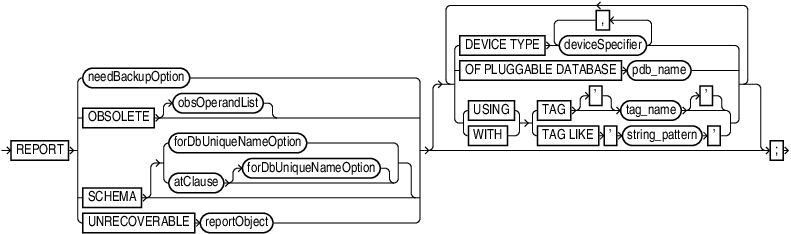

report
This clause specifies the type of report.
| Syntax Element | Description |
Lists files that require backups. See Also: |
Lists full backups, data file copies, and archived redo log files recorded in the RMAN repository that can be deleted because they are no longer needed. See Table 3-6 for description of output. The command works in two steps:
The subclause Note: A backup made with the |
Lists the names of all data files (permanent and temporary) and tablespaces for the target database at the specified point in time. See Table 3-1 for description of output. For |
Reports the names of all data files and tablespaces for the database specified by its You can specify a database with RMAN must be connected to a recovery catalog. RMAN must be connected to a target database or See Also: |
Specifies an SCN, log sequence number, or time. |
Lists all unrecoverable data files. See Table 3-7 for description of output. A data file is considered unrecoverable if an unrecoverable operation has been performed against an object residing in the data file since the last backup of the data file. In an unrecoverable operation, redo is not generated. Examples are direct load of table data and updates with the Note: The nonexistence of any backup of a data file is not sufficient reason to consider it unrecoverable. Such data files can be recovered with the |
DEVICE TYPE deviceSpecifier |
Specifies the type of storage device. RMAN only considers backups and copies available on the specified device for its report. |
OF PLUGGABLE DATABASE
pdb_name |
Reports the backups and copies for the PDB specified by
TAG
tag_name |
Reports the backups and copies with tag specified by
TAG LIKE
string_pattern |
Reports the backups and copies whose tag matches the pattern
specified by |

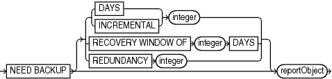

needBackupOption
This clause reports only on files that need backups.
Lists all data files in the specified The report assumes that you restore the most recent backup. If you do not specify any option, then RMAN uses the current retention policy configuration. If the retention policy is disabled ( |
Lists all data files requiring more than the specified number of days' worth of archived redo log files for complete recovery. For example, If the target database control file is mounted and current, then RMAN makes the following optimizations to this report:
Specifies a threshold number of incremental backups required for recovery (see Example 3-19). If complete recovery of a data file requires more than Note: Files for which no backups exist do not appear in this list: issue the |
RECOVERY WINDOW OF integer DAYS |
Reports data files for which there are not sufficient backups to satisfy a recovery window-based retention policy for the specified number of days, that is, data files without sufficient backups for point-in-time recovery to any point back to the time Note:
Specifies the minimum number of backups or copies that must exist for a data file to be considered not in need of a backup. In other words, a data file needs a backup if there are fewer than |
Specifies the object for which you are generating the report. |

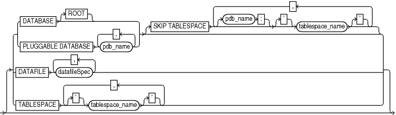

reportObject
This subclause specifies the data files to be included in the report. The report can include the entire database (optionally skipping certain tablespaces), a list of tablespaces, or a list of data files. RMAN includes objects from prior incarnations.
Lists backups or data file copies of all files in the database. Note: Specify |
Specifies the root in a CDB. Connect to the root. |
Lists backups or data file copies in one or more PDBs in a CDB. Use a comma-delimited list to specify multiple PDBs. Connect to the root to report on one or more PDBs using this syntax,. |
Lists the specified data files. RMAN reports on backups or data file copies that contain at least one specified data file. |
Lists data files in the specified tablespace. RMAN reports on backups or data file copies that include at least one data file from a specified tablespace. When connected to the root in a CDB, refers to tablespaces in the root. Refers to tablespaces in a PDB when connected directly to a PDB. |
