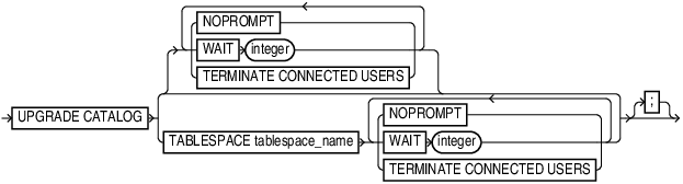

NOPROMPT
Bypasses the confirmation step while upgrading the catalog.
TABLESPACE tablespace_name NOPROMPT
Bypasses the confirmation step while upgrading the specified tablespace.
Syntax Element Description
NOPROMPT
WAIT integer
Specifies a time delay, in seconds, to start the recovery catalog upgrade.
Use the WAIT option to introduce a specific time delay to start the upgrade. This is particularly useful if you want to allow time for blocking connections to complete before starting the recovery catalog upgrade. Blocking connections are catalog schema connections which started before you issued the UPGRADE CATALOG command.
If there are blocking connections at the end of the wait time, then the UPGRADE CATALOG command exits with an error message.
TERMINATE CONNECTED USERS
Use the UPGRADE CATALOG command with the TERMINATE CONNECTED USERS option to start the recovery catalog upgrade immediately after forcibly terminating blocking connections.
Combine the WAIT option and the TERMINATE CONNECTED USERS option to run UPGRADE CATALOG after a given delay and after forcibly terminating all blocking connections at the end of the time delay.
