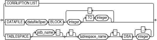

(validateObject::=, validateOperand::=)
validateObject::=
(archivelogRecordSpecifier::=, copyOfSpec::=, blockObject::=, datafileCopySpec::=, datafileSpec::=)
copyOfSpec::=

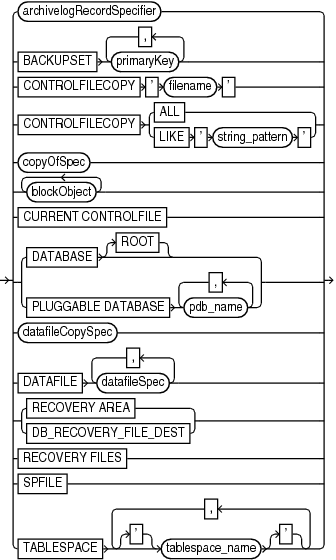

validateObject
This subclause specifies database files for validation. Refer to validateObject::= for syntax.
| Syntax Element | Description |
Validates a range of archived redo log files. |
Checks that the backup sets specified by You can obtain the primary keys of backup sets by executing a The Use If you do not have automatic channels configured, then manually allocate at least one channel before executing Note: If multiple copies of a backup set exist, then RMAN validates only the most recent copy. The |
CONTROLFILECOPY{'filename' | ALL |LIKE 'string_pattern'} |
Validates control file copies. You can specify a control file copy in one of the following ways:
The control file copy can be created with the |
Validates image copies of data files and control files. See Also: |
Validates the current control file. |
Validates the whole CDB. Connect to the root as a common user with the
When connected to a pluggable database (PDB), validates the PDB. RMAN validates all data files and control files. If the database is currently using a server parameter file, then RMAN validates the server parameter file. Note: The online redo log files and temp files are not validated. |
Validates only the CDB root. |
In a CDB, validates the specified PDBs. Use a comma-delimited list to specify
multiple PDBs. Connect to the root as a common user or local user with the
Validates one or more data file image copies. When validating data file copies, RMAN checks for block corruption but does not terminate the validation if corruption is discovered. Unlike See Also: |
Specifies a list of one or more data files that contain blocks requiring validation. Note: You do not have to take a data file offline if you are validating it. See Also: |
Validates recovery files created in the current and all previous fast recovery area destinations. Recovery files are full and incremental backup sets, control file autobackups, archived redo log files, and data file copies. Flashback logs, the current control file, and online redo logs are not validated. |
Semantically equivalent to |
Validates all recovery files on disk, whether they are stored in the fast recovery area or other locations on disk. Recovery files include full and incremental backup sets, control file autobackups, archived redo log files, and data file copies. Flashback logs are not validated. |
Validates the server parameter file currently used by the database. RMAN cannot validates other copies of the server parameter file, and cannot validate the server parameter file when the instance was started with an initialization parameter file. |
TABLESPACE tablespace_name |
