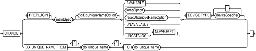

Use the CHANGE command to perform the following tasks:
  • Update the availability status of backups and copies recorded in the RMAN repository
  • Change the priority of or close failures recorded in the automatic diagnostic repository
  • Update the DB_UNIQUE_NAME recorded in the recovery catalog for the target database
  • Associate the backup of a database in a Data Guard environment with a different database in the environment

change
This clause enables you to change the status of RMAN repository records. To obtain the primary keys of RMAN repository records whose status you want to change, run a LIST command or query the recovery catalog views.
Syntax Element Description
PREPLUGIN
Specifies the preplugin files that you want to CHANGE.
maintSpec
Specifies which files you want to CHANGE.
The maintQualifier clause sets rules for the repository records that must be changed. To change the status of repository records associated with PDBs that were dropped, use the GUID clause to specify the GUID of the dropped PDB. The dba_pdb_history view contains the GUID of dropped PDBs.
See Also: maintSpec for descriptions of the options in this clause.
   forDbUniqueNameOption
Changes the metadata for objects that are exclusively associated with the specified DB_UNIQUE_NAME in a Data Guard environment.
See Also: forDbUniqueNameOption for descriptions of the options in this clause.
