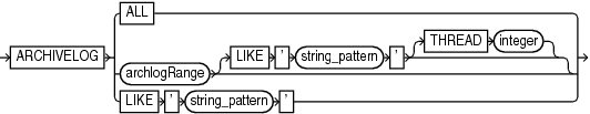

4.2 archivelogRecordSpecifier
Purpose
Use the archivelogRecordSpecifier subclause to specify a set of archived redo log files for use in RMAN operations.
Semantics
This subclause specifies either all archived redo log files or logs with file names that match a specified pattern.
Syntax Element Description
ALL
Specifies all available archived logs.
LIKE 'string_pattern'
Specifies all archived logs that match the specified string_pattern. You can use the same pattern matching characters that are valid in the LIKE operator in the SQL language to match multiple files.
See Also:Oracle Real Application Clusters Administration and Deployment Guideto learn about using RMAN in an Oracle RAC configuration

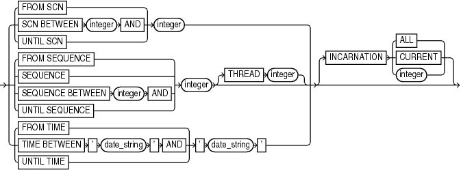

archlogRange
This subclause specifies a range of archived redo log files by SCN, time, restore point (which is a label for a timestamp or SCN), or log sequence number. This subclause is useful for identifying the point to which you want the database to be recoverable.
RMAN queries the V$ARCHIVED_LOG or RC_ARCHIVED_LOG view to determine which logs to include in the range. When you specify a time, SCN, or restore point, RMAN determines the range according to the contents of the archived redo log files, not when the logs were created or backed up. When you specify the range by log sequence number, then RMAN uses the sequence number to determine the range.
Table 4-1 explains how RMAN determines which logs are in the range. The columns FIRST_TIME, NEXT_TIME, and so on refer to columns in V$ARCHIVED_LOG. Additionally, the column INCARNATION corresponds to the incarnation column in the v$database_incarnation table which is joined with v$archived_log on the resetlogs_change# and resetlogs_time columns.
For example, if you specify FROM SCN 1000 UNTIL SCN 2000, then RMAN includes all logs whose V$ARCHIVED_LOG.NEXT_SCN value is greater than 1000 and whose V$ARCHIVED_LOG.FIRST_SCN value is less than or equal to 2000.
Table 4-1 Determining Logs for Inclusion in the Range
Subclause FIRST_TIME NEXT_TIME FIRST_SCN NEXT_SCN SEQUENCE# INCARNATION#
FROM TIME t1
n/a
Later than t1
n/a
n/a
n/a
n/a
FROM TIME t1 UNTIL TIME t2
Earlier than or equal to t2
Later than t1
n/a
n/a
n/a
n/a
UNTIL TIME t2
n/a
n/a
n/a
n/a
n/a
FROM SCN s1
n/a
n/a
n/a
Greater than s1
n/a
n/a
FROM SCN s1 UNTIL SCN s2
n/a
n/a
Less than or equal to s2
Greater than s1
n/a
n/a
UNTIL SCN s2
n/a
n/a
n/a
n/a
n/a
FROM SEQUENCE q1
n/a
n/a
n/a
n/a
Between q1 and the maximum sequence (inclusive)
n/a
FROM SEQUENCE q1 UNTIL SEQUENCE q2
n/a
n/a
n/a
n/a
Between q1 and q2 (inclusive)
n/a
UNTIL SEQUENCE q2
n/a
n/a
n/a
n/a
Between 0 and q2 (inclusive)
n/a
INCARNATION ALL
n/a
n/a
n/a
n/a
n/a
ANY
INCARNATION CURRENT
n/a
n/a
n/a
n/a
n/a
Active incarnation number
INCARNATION i
n/a
n/a
n/a
n/a
n/a
Equals i
The time must be formatted according to the Globalization Technology date format specification currently in effect. If your current Globalization settings do not specify the time, then string dates default to 00 hours, 00 minutes, and 00 seconds.
The date_string can be any SQL expression of type DATE, such as SYSDATE. You can use TO_DATE to specify hard-coded dates that work regardless of the current Globalization Technology settings. SYSDATE always has seconds precision regardless of the Globalization settings. Thus, if today is March 15, 2013, then SYSDATE-10 is not equivalent to 05-MAR-13 or TO_DATE('03/15/2013','MM/DD/YYYY')-10.
SYSDATE uses the time zone of either the database host system, or the database depending on the setting of the TIME_AT_DBTIMEZONE initialization parameter. See Oracle AI Database Reference for more information.
Specifying a sequence of archived redo log files does not guarantee that RMAN includes all redo data in the sequence. For example, the last available archived log file may end before the end of the sequence, or an archived log file in the range may be missing from all archiving destinations. RMAN includes the archived redo log files it finds and does not issue a warning for missing files.
If the database is open when you run BACKUP ARCHIVELOG, and if the UNTIL clause is specified, then RMAN does not run ALTER SYSTEM ARCHIVE LOG CURRENT.
See Also:
Oracle AI Database Reference to learn how to use the NLS_LANGUAGE and NLS_DATE_FORMAT environment variables to specify time format
FROM SCN integer
Specifies the beginning SCN for a range of archived redo log files. If you do not specify the UNTIL SCN parameter, then RMAN includes all available log files beginning with SCN specified in the FROM SCN parameter.
SCN BETWEEN integer AND integer
Specifies the beginning and ending SCN for a range of logs. This syntax is semantically equivalent to FROM SCN integer1 UNTIL SCN integer2.
UNTIL SCN integer
Specifies the ending SCN for a range of archived redo log files (see Table 4-1 for the rules determining the range).
FROM SEQUENCE integer
Specifies the beginning log sequence number for a sequence of archived redo log files (see Table 4-1 for the rules determining the range).
Note: You can specify all log sequence numbers in a thread by using the syntax shown in Example 4-9.
SEQUENCE integer
Specifies a single log sequence number.
SEQUENCE BETWEEN integer AND integer
Specifies a range of log sequence numbers. This syntax is semantically equivalent to FROM SEQUENCE integer1 UNTIL SEQUENCE integer2.
Specifies the terminating log sequence number for a sequence of archived redo log files (see Table 4-1 for the rules determining the range).
   THREAD integer
Specifies the thread containing the archived redo log files you want to include. This parameter is only necessary if the database is in an Oracle RAC configuration.
Although the SEQUENCE parameter does not require that THREAD be specified, a given log sequence always implies a thread. The thread defaults to 1 if not specified. Query V$ARCHIVED_LOG to determine the thread number for a log.
INCARNATION ALL|CURRENT|integer
Specifies the database incarnation for archived redo logs for the BACKUP, RESTORE and LIST commands. INCARNATION enables you to designate either current archive redo logs, archive redo logs from a previous incarnation of the database or all redo logs. CURRENT is the default.
Note: The INCARNATION subclause is not valid for foreign archived redo log files that are received by a logical standby database for a LogMiner session. Unlike normal archived redo log files, foreign archived redo log files have a different DBID and cannot be backed up or restored on a logical standby database.
FROM TIME 'date_string'
Specifies the beginning time for a range of archived redo log files (see Table 4-1 for the rules determining the range). Example 4-8 shows FROM TIME in a LIST command.
TIME BETWEEN 'date_string' AND 'date_string'
Specifies a range of times. This syntax is semantically equivalent to FROM TIME 'date_string' UNTIL TIME 'date_string'.
Specifies the end time for a range of archived redo log files (see Table 4-1 for the rules determining the range). Example 4-7 shows UNTIL TIME in a BACKUP command.
