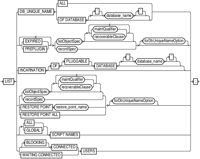

Syntax
(listObjectSpec::=, recordSpec::=, maintQualifier::=, forDbUniqueNameOption::=, untilClause::=)
(completedTimeSpec::=, deviceSpecifier::=)
(listObjList::=, listBackupOption::=, archivelogRecordSpecifier::=, foreignlogRecordSpecifier::=)
Semantics
list
Syntax Element | Description |
Lists the RMAN must be connected to a recovery catalog. RMAN must also be connected to a mounted or open target database, or you must identify the target database with the See Also: Table 2-26 for a description of the output |
Lists the |
OF DATABASE database_name |
Lists the |
Displays backup sets, proxy copies, and image copies marked in the repository as To ensure that |
Lists preplugin backups. |
Specifies the type of expired object or objects that you are listing. See Also: |
Restricts the range of the listing. See Also: To display backups of PDBs that were dropped, use the |
Specifies the expired object or objects that you are listing. See Also: |
Lists the expired files in You can specify a database with RMAN must be connected to a recovery catalog. RMAN must also be connected to a mounted or open target database, or you must have run the See Also: |
Displays information about the incarnations of a database. Whenever you open a database with the The See Also: Table 2-23 for an explanation of the column headings of the |
Specifies the name of the database. If you do not specify the |
OF PLUGGABLE DATABASE pluggable_database_name |
Specifies the name of the PDB. Information about all incarnations of the specified PDB is displayed. You must connect to the root as a common user with the |
Restricts the range of the listing. See Also: |
Restricts the list to data file backups or copies whose status in the repository is See Also: |
Specifies the object or objects that you are listing. See Also: |
Specifies an end time, SCN, or log sequence number. See Also: |
Displays restore points known to the RMAN repository. See Also: Table 2-25 for an explanation of the column headings of the |
Displays the specified restore point. |
Displays all restore points known to the RMAN repository. |
Lists the backups and restore points that are exclusively associated with the specified You can specify a database with RMAN must be connected to a recovery catalog. RMAN must also be connected to a mounted or open target database. See Also: |
RMAN lists all global and local scripts defined for all databases in the connected recovery catalog, along with any descriptive comments. You must be connected to a recovery catalog, but you do not need to be connected to a target database. |
RMAN lists only global scripts defined in the connected recovery catalog, along with any descriptive comments. You must be connected to a recovery catalog, but you do not need to be connected to a target database. |
Lists local and global scripts that can be executed on the current target database. You must be connected to a target database and a recovery catalog to use this form of the command. See Also: Table 2-24 for a description of the output and Example 3-17 for an illustration |
Lists all the recovery catalog schema connections. To run the See the Backup and Recovery User's Guide to learn how to manage catalog schema connections. |
Lists all the catalog schema connections that are blocking the progress of a recovery catalog upgrade. To run the Blocking connections are catalog schema connections that started before you issued the Therefore, after you issue the See Also: SET See Also: TERMINATE See Also: UPGRADE CATALOG See the Backup and Recovery User's Guide to learn how to use the RMAN maintenance mode to manage catalog schema connections. |
Lists all the recovery catalog schema connections that are waiting for a recovery catalog upgrade to complete. To run the Starting with Oracle AI Database 26ai, after you issue the See Also: SET See Also: TERMINATE See Also: UPGRADE CATALOG See the Backup and Recovery User's Guide to learn how to use the RMAN maintenance mode to manage catalog schema connections. |

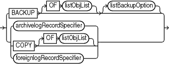

listObjectSpec
This subclause specifies the type of object or objects that you are listing.
Displays information about backup sets (including detail on backup pieces) and proxy copies. See Also: Table 2-8 for a description of |
Restricts the list of objects operated on to the object type specified in the Note: The See Also: |
Specifies whether to list summary information about backups or detailed information. |
Displays information about a range of archived redo log files. |
Displays only information about data file copies, archived redo log files, and image copies of archived redo log files. By default, See Also: Table 2-20 and Table 2-22 for an explanation of the column headings of the |
Restricts the list of objects operated on to the object type specified in the See Also: |
Displays information about a range of foreign archived redo log files. |
