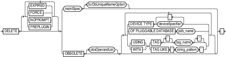

Syntax
delete::=
(maintSpec::=, obsOperandList::=, deviceSpecifier::=)
(listObjList::=, archivelogRecordSpecifier::=, maintQualifier::=, deviceSpecifier::=, recordSpec::=)
Semantics
| Syntax Element | Description |
Deletes specified files—whether or not they exist on the media—and removes repository records (see Example 2-80). RMAN ignores any I/O errors for the deleted objects. RMAN also ignores any |
Deletes specified files without first listing the files or prompting for confirmation. The |
Deletes preplugin backups and removes their repository records. |
Removes only files whose status in the repository is If for some reason a backup marked |
Deletes backups and copies. You can set rules for the deletion with the When deleting backups of PDBs that were dropped, you identify the PDB using its GUID. Use the Note: Note: In CDBs, you must connect to the root as a user with the See Also: |
Deletes the backups and copies in Note: The If RMAN successfully deletes tape backups associated with the specified Note: You cannot use See Also: |
Deletes data file backups and copies recorded in the RMAN repository that are obsolete, that is, no longer needed (see Example 2-78). RMAN also deletes obsolete archived redo log files and log backups. RMAN determines which backups and copies of data files are no longer needed, which in turn determines when logs (and backups of logs) are no longer needed. RMAN considers the creation of a data file as a backup when deciding which logs to keep. RMAN first uses the options specified with Note: Note: If you make a backup with the Note: The |
Specifies the criteria for determining which backups and copies are obsolete. See Also: |
DEVICE TYPE deviceSpecifier |
Restricts the deletion to obsolete backups and copies created on the specified device type only. See Also: |
OF
PLUGGABLE DATABASE
pdb_name |
backups and copies of the PDB
TAG
tag_name |
backups and copies with the TAG specified by
TAG
LIKE
string_pattern |
Restricts the deletion to obsolete backups and copies with TAG values that match the specified string pattern. |
