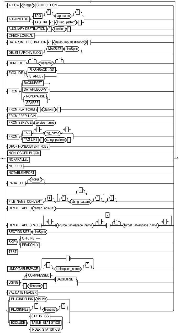

recoverOptionList
Specifies recovery options.

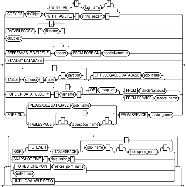

recoverObject
This subclause specifies which files to recover. Refer to recoverObject::= for the syntax diagram.
Syntax Element Description
COPY OF dbObject
Applies incremental backups to the specified image copy to roll it forward to any time equal to or before the most recent incremental backup of the file. The existing image copy is overwritten and remains in a fuzzy state during the recovery. RMAN makes an autobackup after recovering the image copy.
This command updates a data file copy and is not a media recovery of a current database file. This command is meant to be used with the BACKUP ... FOR RECOVER OF COPY syntax to implement a strategy using incrementally updated backups.
The following requirements must be met:
  • At least one copy of each data file that you are recovering must exist.
  • Incremental backups taken after the image copy that you are recovering must exist.
RMAN selects one suitable copy if there are multiple possible copies to which the incremental backups can be applied to carry out the operation.
Note: RMAN issues a warning (not an error) if it cannot recover to the specified time because no incremental backups are available.
   WITH TAG tag_name
Specifies a tag name to identify the image copy to be rolled forward.
DATAFILECOPY 'filename'
Applies incremental backups to the specified data file image copy (see Example 3-4). Refer to description of RECOVER COPY OF.
dbObject
Specifies the data blocks that require recovery.
STANDBY DATABASE
Applies incremental backups, rolls forward, and then restarts the physical standby database.
Use the FROM SERVICE clause to specify the primary database required to refresh the standby database. First, connect to the physical standby database as target, and then specify the net service name of the primary database using the FROM SERVICE clause.
Note: PFILE and FROM SERVICE are the only options allowed with the STANDBY DATABASE clause.
FOREIGN DATAFILECOPY 'filename'
Specifies the names of the foreign data file copies that need to be made consistent by applying an incremental backup. These foreign data file copies were created during an inconsistent cross-platform backup by using either the CONVERT or BACKUP command with the ALLOW INCONSISTENT clause.
FROM BACKUPSET 'filename'
Specifies the name of the backup set containing the cross-platform incremental backup that must be applied to the foreign data file copies specified using the FOREIGN DATAFILECOPY 'filename' clause.
The following conditions must be satisfied for a cross-platform incremental backup to be applied:
  • The start SCN of each data file in the cross-platform incremental backup must be less than the current checkpoint SCN of the foreign data file copy.
  • The foreign data file copy must not be modified.
    For example, it should not have been plugged in to the target database, changed to read-write mode, and then changed back to read-only mode. This changes the database ID and file number in the foreign data file copy header.
If these conditions are not met, an error occurs and the cross-platform incremental backup is not applied to the foreign data file copies.
Note: You cannot apply an incremental backup consisting of multiple backup sets to a set of foreign data files.
TABLE schema.table[:partition]
Specifies the tables or table partitions that must be recovered. The target database must be in read-write mode.
Before performing the recovery, RMAN checks if there is sufficient space on the target host to store files for the auxiliary instance that is used during recovery. If sufficient space does not exist, then RMAN displays an error message and exits.
You can assign new names for recovered tables or table partitions in the target database by using the REMAP TABLE option.
When the recovered tables are imported into the target database, if a table with the same name exists in the target database, an error message is displayed indicating that the REMAP TABLE clause must be used to rename the tables.
When you recover only certain partitions from a partitioned table, each partition is imported into the target database as separate table. If REMAP TABLE is not used to rename recovered objects, RMAN names each table by using a concatenation of the table name and partition name. The table names of the recovered objects are in the format tablename_partitionname. If a table with this name exists in the target database, RMAN appends _1 to the generated table name. If a table with this name too exists, RMAN appends _2 to the table name, and so on.
See Example 3-8
OF PLUGGABLE DATABASE pdb_name
In a CDB, the name of a PDB in which the table or table partition that must be recovered resides. To recover tables or table partitions in a PDB, you must connect to the root.
FOREIGN PLUGGABLE DATABASE pdb_name
Specifies that the pluggable database (PDB) specified by the pdb_name must be transported to a destination database.
Starting with Oracle AI Database 26ai, RMAN can use the network to connect to a source PDB, create a backup of a PDB, transfer the source data files optimally over the network, and then restore the data files from backups on the destination CDB. RMAN also plugs in the a PDB on the destination CDB.
While transporting a PDB over the network, you must first restore a incremental level 0 backup of the PDB on the destination CDB. You can then run the RECOVER command along with the FOREIGN PLUGGABLE DATABASE clause and the FROM SERVICE clause to periodically roll forward the level 0 backup of the PDB on the destination CDB, until you want to perform a final restore operation.
See, Transporting Pluggable Databases Over the Network in the Backup and Recovery User's Guide to learn how to transport PDBs over the network using RMAN.
FOREIGN TABLESPACE tablespace_name
Specifies that the tablespace tablespace_name must be transported to a destination database.
Starting with Oracle AI Database 26ai, you can use RMAN to transport tablespaces over the network from a source database to a destination database. RMAN can connect to a source database, create the required backups of a tablespace, transfer the data files optimally over the network, and then restore the data files on the destination database. RMAN also plugs in the tablespace on the destination database.
While transporting a tablespace over the network, you must first run the RESTORE command along with the FOREIGN TABLESPACE clause and the FROM SERVICE clause. RMAN restores the data files from a backup of the source tablespace.
You can optionally run the RECOVER command along with the FOREIGN TABLESPACE clause and the FROM SERVICE clause. RMAN rolls forward the previously restored data files using the incremental level 1 backups of the source tablespace.
See, Transporting Tablespaces Over the Network in the Backup and Recovery User's Guide to learn more about transporting tablespaces over the network.
FROM SERVICE service_name
Recovers data files using backups that are transferred over the network from a source database. service_name specifies the service name of the source database.
See, Backup and Recovery User's Guide to learn about transporting PDBs and tablespaces over the network.
SKIP
Takes the data files in the specified tablespaces offline before starting media recovery. These files are left offline after the media recovery is complete.
This option is useful for avoiding recovery of tablespaces containing only temporary data or for postponing recovery of some tablespaces.
   FOREVER
Takes the data files offline with the DROP option (see Example 3-3). Use SKIP FOREVER TABLESPACE when you intend to drop the specified tablespaces after opening the database with the RESETLOGS option.
Note: If you perform incomplete recovery, then SKIP requires the FOREVER option.
Specifies the name of the tablespace to take offline.
TABLESPACE pdb_name:tablespace_name
The name of a tablespace in a PDB.
TO RESTORE POINT restore_point_name
Specifies a restore point for termination of the RECOVER command, with the SCN at which the restore point was created as the upper, inclusive limit. Because the limit is inclusive, RMAN selects only files that it can use to recover up to and including the SCN corresponding to the restore point.
untilClause
Specifies a past time, SCN, or log sequence number for termination of the RECOVER command.
When used with one or more tablespaces, the clause indicates a tablespace point-in-time recovery (TSPITR) operation for the named tablespaces. Do not use this clause with RECOVER DATAFILE or for RECOVER DATABASE (see "Usage Notes"). After database point-in-time recovery (DBPITR), you must open the database with the RESETLOGS option.
See Also: untilClause
UNTIL AVAILABLE REDO
Finds the last available archived redo log and online redo logs, and recovers the database to the point where a log is missing.
You can use this option only while performing recovery for a whole database. You cannot recover a data file, tablespace, or PDB using the UNTIL AVAILABLE REDO option.
To perform point-in-time recovery for a PDB, you must specify the SCN for recovery.

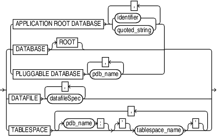

dbObject
This subclause specifies whether to recover the database or a subset of the database. Refer to dbObject::= for the syntax diagram.
APPLICATION ROOT DATABASE
Specifies all data files in the application root.
Connect to the CDB root as a common user with the SYSDBA or SYSBACKUP privilege. Or, connect to application root as an application common user with the SYSDBA or SYSBACKUP privilege.
DATABASE
Specifies the entire database CDB. To recover the entire CDB, you must connect to the root as a common user with the SYSDBA or SYSBACKUP privilege.
In an application container, recovers the entire application container to the specified point in time. This includes the application root and all application PDBs that belong to this application root. You connect to the application root as an application common user with the SYSDBA or SYSBACKUP privilege.
By default, the RECOVER DATABASE command does not recover files that are offline normal at the point in time to which the files are being recovered. RMAN omits offline normal files with no further checking.
When recovering after the loss of control files, RMAN automatically updates the control file to point to the actual location of the data files on disk (see Example 3-5).
If RMAN encounters redo for adding a data file, then RMAN automatically creates a new data file unless the tablespace containing the added data file is skipped during recovery. This situation can arise when a backup control file is restored before recovery and the backup control file does not contain a record of the recently-added data file.
DATABASE ROOT
Specifies only the root in a CDB. Connect to the root as a common user with the SYSDBA or SYSBACKUP privilege.
In an application container, recovers online data files belonging to the application root and all the application PDBs. Connect to the application root as an application common user with the SYSDBA or SYSBACKUP privilege.
Specifies one or more PDBs in a CDB. No other PDBs are affected; they can remain open and operational. Use a comma-delimited list to specify multiple PDBs. To recover multiple PDBs, connect to the root as a common user with the SYSDBA or SYSBACKUP privilege. To perform complete recovery of a particular PDB, connect to the PDB as a common user or local user with the SYSDBA or SYSBACKUP privilege.
You must connect to the root, as a common user with the SYSDBA or SYSBACKUP privileges, to perform any of the following operations for PDBs: point-in-time recovery, table recovery, TSPITR, or duplication.
In an application container, connect to the CDB root as a common user with the SYSDBA or SYSBACKUP privilege and specify the name of the application root in pdb_name to recover the application root and all application PDBs.
To recover an application PDB, connect to the application root as an application common user with the SYSDBA or SYSBACKUP privilege. To recover multiple application PDBs, specify a common-separated list of application PDB names.
DATAFILE datafileSpec
Specifies a list of one or more data files by either file name or absolute data file number.
The target database must be mounted or open. If the database is open, then the data files to be recovered must be offline.
If you are not using a recovery catalog, then the file name must be the name of the data file as recorded in the control file. If you are using a recovery catalog, then the file name of the data file must be the most recent name recorded in the catalog, even if the name in the control file has been updated more recently. For example, assume that a data file was renamed in the control file, but the instance fails before you resynchronize the catalog. Specify the old name of the data file in the RECOVER command because this is the name recorded in the catalog.
Note: You cannot arbitrarily recover individual data files to different points in time, although you can recover the whole database to a single point in time or recover wholly contained tablespaces to a point in time different from the rest of the database (TSPITR). For more information on TSPITR, see the procedure described in Oracle AI Database Backup and Recovery User’s Guide.
See Also: datafileSpec
Specifies a list of one or more tablespaces. The target database must be mounted or open. If the database is open, then the tablespaces to be recovered must be offline.
When connected to the root, specifies the tablespaces in the root container. Specifies the names of tablespaces in a PDB when connected to a PDB.
Note: If the RMAN encounters redo for adding a data file, then RMAN automatically creates a new data file. This situation can arise when a backup control file is restored before recovery and the backup control file does not contain a record of the recently-added data file.
TABLESPACE pdb-name:tablespace_name
The name of the tablespace in a PDB. Multiple PDBs can have tablespaces with the same name. A qualifier before the name uniquely identifies the tablespace. This syntax is needed only when connected to the root. When connected directly to a PDB, use TABLESPACE tablespace_name. pdb-name is the name of a PDB.
See the previous description for TABLESPACE for general information.

recoverOptionList
This subclause specifies various recovery options. Refer to recoverOptionList::= for the syntax diagram.
ALLOW integer CORRUPTION
Specifies the number of corrupt blocks that can be tolerated while allowing recovery to proceed. You can set this parameter in case of redo log corruption.
ARCHIVELOG TAG tag_name
Specifies the tag for an archived log backup to be used during recovery. Tag names are not case sensitive and display in all uppercase. If the tagged backup does not contain all the necessary archived redo log files for recovery, then RMAN uses logs or incremental backups as needed from whatever is available.
AUXILIARY DESTINATION 'location'
Specifies a location where auxiliary set data files, control files, and online redo logs are created during TSPITR if another location for an individual file is not explicitly specified.
If you do not specify AUXILIARY DESTINATION for a TSPITR, then you must specify the naming of individual auxiliary set data files, control files, and online redo logs before executing RECOVER TABLESPACE with the UNTIL clause. Otherwise, TSPITR fails.
While performing point-in-time recovery of PDBs, if no auxiliary destination is specified, then the fast recovery area is used as the auxiliary destination. When an auxiliary destination is not specified and a fast recovery area is not configured, the recovery of the PDB fails.
See also: The chapter on TSPITR in Oracle AI Database Backup and Recovery User’s Guide for more details about the auxiliary destination
CHECK LOGICAL
Tests data and index blocks that pass physical corruption checks for logical corruption, for example, corruption of a row piece or index entry. If RMAN finds logical corruption, then it logs the block in the alert.log and server session trace file.
The SET MAXCORRUPT setting represents the total number of physical and logical corruptions permitted on a file. By default, MAXCORRUPT is 0, so that if any corrupt blocks exist, media recovery fails. If recovery including corrupt blocks is permissible, then set MAXCORRUPT to the smallest number of corrupt blocks that causes media recovery to fail. For example, to tolerate one corrupt block, set MAXCORRUPT to 1.
If the total number of physical and logical corruptions detected for a file is less than its MAXCORRUPT setting, then the RMAN command completes and the database populates V$DATABASE_BLOCK_CORRUPTION with corrupt block ranges. Otherwise, the command terminates without populating V$DATABASE_BLOCK_CORRUPTION.
DATAPUMP DESTINATION 'datapump_destination'
Specifies the location of the Data Pump export dump file that contains the tables or table partitions that are recovered from an RMAN backup.
If you do not specify a Data Pump destination, RMAN creates the export dump file in the destination indicated by AUXILARY DESTINATION. If no auxiliary destination is specified, RMAN creates the dump file in a default operating system-specific location. On Linux, the default location is $ORACLE_HOME/dbs. On Windows the default location is %ORACLE_HOME\database.
DELETE ARCHIVELOG
Deletes archived redo log files restored from backups or copies that are no longer needed. RMAN does not delete archived redo log files that were on disk before the RESTORE command started. If you do not specify MAXSIZE, then RMAN deletes restored archived redo log files as they are applied.
Note: If archived redo log files are restored to the fast recovery area, then the DELETE ARCHIVELOG option is enabled by default.
   MAXSIZE sizeSpec
Does not use more than sizeSpec amount of disk space for restored archived redo log files. If recovery requires the restore of a log larger than the MAXSIZE value, then RMAN reports an error indicating that you must increase the MAXSIZE value. If MAXSIZE is smaller than the backup set containing the logs, then RMAN must read the backup set more than once to extract the logs. In this situation, RMAN issues a warning to increase MAXSIZE.
Note: To conserve space during tablespace recovery, consider using the DELETE ARCHIVELOG option and the MAXSIZE option. This approach may help to avoid recovery failure caused due to space constraints, but may increase the potential recovery time.
This example recovers a tablespace users and allocates 100K disk space for archived redo log files. If recovery requires the restore of a log larger than 100K, then RMAN reports an error indicating that you must increase the MAXSIZE value.
RECOVER TABLESPACE users DELETE ARCHIVELOG MAXSIZE 100K;
DUMP FILE 'filename'
Specifies the name of the Data Pump export dump file that contains the recovered tables or table partitions. If you do not specify a name for the dump file, RMAN assigns a default name based on the operating system of the target database. The default name is tspitr_SID-of-clone_n.dmp where SID-of-clone is the Oracle SID of the auxiliary database used by RMAN for recovery and n is a randomly-generated number. The dump file is created in the location specified by DATAPUMP DESTINATION.
If DATAPUMP DESTINATION contains a file with the name specified in DUMP FILE, the recovery process fails.
See Also: DATAPUMP DESTINATION
EXCLUDE FLASHBACK LOG
Does not search the flashback logs for blocks to restore. By default, RMAN searches the flashback logs if Flashback Database is enabled.
EXCLUDE STANDBY
Does not search a physical standby database for blocks to restore. By default, in a Data Guard environment RMAN searches the blocks from a physical standby database.
FROM BACKUPSET
Specifies that only backup sets are restored. This clause is supported only while performing block media recovery. The RECOVER ... BLOCK command is used to perform block media recovery.
FROM DATAFILECOPY
Restores only data file image copies.
FROM SPARSE
Recovers data files from archive logs and redo logs after restoring data files from the selected sparse backup. RMAN first restores data files from sparse backups and then recovers the data files.
To perform recovery with the FROM SPARSE clause, the COMPATIBLE initialization parameter of the sparse database being restored must be 12.2 or higher.
Note: This clause can be used only when performing point-in-time recovery.
FROM NONSPARSE
Performs traditional complete recovery for the specified non-sparse database. Data files are first restored from non-sparse backups and then recovered. To perform point-in-time recovery with the FROM NONSPARSE clause, the COMPATIBLE initialization parameter of the sparse database being restored must be set to 12.2 or higher. Data files are restored from non-sparse backups first and then recovered.
FROM PLATFORM 'platform'
Specifies the name of the source platform on which the cross-platform backup was created. The platform name specified must match the platform identifier stored in the cross-platform backup header.
This clause is required when conversion is performed on the destination database. If conversion is performed on the source database (by using the TO PLATFORM clause in the BACKUP command), then this clause is optional. When this clause is omitted, you can still recover a cross-platform backup by specifying the FOREIGN DATAFILECOPY clause with the FROM BACKUPSET clause.
To perform cross-platform tablespace transport by connecting over the network to a remote database, use the FROM PLATFORM clause with the FROM SERVICE clause. RMAN then creates the required backup sets on the source database, transfers them to the destination database, and then restores them on the destination.
See FOREIGN DATAFILECOPY 'filename'.
See Also: Oracle AI Database Backup and Recovery User’s Guide for more information about source and destination platform conversion.
FROM PREPLUGIN
Uses preplugin incremental backups and preplugin archive redo log backups to recover a PDB. The PDB may be a source non-CDB or a PDB that was plugged in to the current CDB.
Recovers data files using backup sets that are transferred, over the network, from a remote database. service_name specifies the service name of the remote database.
See "Restoring Data Files and Control Files Using Files from a Remote Host".
To perform cross-platform tablespace transport by connecting over the network to a remote database, use the FROM PLATFORM clause with the FROM SERVICE clause. RMAN connects to the source database, creates the required backups, transfers them to the destination, and then restores the backups on the destination.
NONLOGGED BLOCK
Extends the recovery to nonlogged blocks which are listed in the V$NONLOGGED_BLOCK view. RMAN first performs a validation to determine the nonlogged block ranges and then uses these ranges to perform recovery of the objects specified in the dbObject clause. In Oracle Database 11.2 and earlier releases, information about nonlogged blocks was available in the V$DATABASE_BLOCK_CORRUPTION view.
When run on a physical standby database, RECOVER fetches data blocks from the primary database. When run on a primary database, data blocks are fetched from the most appropriate standby database. In this case, the primary database must be mounted.
You must stop standby recovery before issuing a RECOVER command with this option.
If the target database does not use Automatic Memory Management and the SGA_TARGET parameter is not set, then you must specify a value for the DATA_TRANSFER_CACHE_SIZE initialization parameter.
See Also: Oracle Data Guard Concepts and Administration
See Also: Oracle AI Database Administrator’s Guide
See Also: Oracle AI Database Reference
FROM TAG 'tag_name'
Specifies the tag for an incremental backup to be used during recovery. If the tagged backup does not contain all the necessary incrementals for recovery, then RMAN uses logs or incremental backups as needed from whatever is available. Tag names are not case sensitive and display in all uppercase.
See Also: BACKUP to learn how a tag can be applied to an individual copy of a duplexed backup set, and to learn about the default file name format for backup tags
NOPARALLEL
Does not perform media recovery in parallel. Parallel execution is the default for RECOVER (see the description of the RECOVER ... PARALLEL option).
NOREDO
Suppresses the application of redo logs during recovery. Only incremental backups are applied.
One use of this option is to use incremental backups to update full backups of NOARCHIVELOG databases (see Example 3-6). The NOREDO options is required if redo logs are not available. If you do not specify NOREDO when recovering a NOARCHIVELOG database, then RMAN ends recovery and issues an error.
Note: Incremental backups of NOARCHIVELOG databases can only be taken after a consistent shutdown.
Another use is to update standby or duplicate databases. Incremental backups created with the BACKUP INCREMENTAL FROM SCN command can be applied at a standby or duplicate database. The standby database procedure is described in Oracle Data Guard Concepts and Administration.
NOTABLEIMPORT
Specifies that RMAN must not import recovered tables or table partitions into the target database.
The recovered objects are stored in an Data Pump export dump file that is specified using DUMP FILE and DATAPUMP DESTINATION. If these clauses are omitted, the export dump file is created in a default location.
When required, you need to explicitly import the tables or table partitions contained in the export dump file into the target database. Use the Data Pump import utility to import the recovered objects.
Note: You cannot use NOTABLEIMPORT with the REMAP TABLE or REMAP TABLESPACE clauses.
PARALLEL
Specifies parallel recovery (default).
By default, the database uses parallel media recovery to improve performance of the roll forward phase of media recovery. To override the default behavior of performing parallel recovery, use the RECOVER with the NOPARALLEL option, or RECOVER PARALLEL 0.
In parallel media recovery, the database uses a "division of labor" approach to allocate different processes to different data blocks while rolling forward, thereby making the operation more efficient. The number of processes is derived from the CPU_COUNT initialization parameter, which by default equals the number of CPUs on the system. For example, if parallel recovery is performed on a system where CPU_COUNT is 4, and only one data file is recovered, then four spawned processes read blocks from the data file and apply redo.
Typically, recovery is I/O-bound on reads from and writes to data blocks. Parallelism at the block level may only help recovery performance if it increases total I/Os, for example, by bypassing operating system restrictions on asynchronous I/Os. Systems with efficient asynchronous I/O see little benefit from parallel media recovery.
Note: The RECOVERY_PARALLELISM initialization parameter controls instance or crash recovery only. Media recovery is not affected by the value used for RECOVERY_PARALLELISM.
See Also: The description of the PARALLEL clause in the discussion of CREATE TABLE in Oracle AI Database SQL Language Reference
   integer
Specifies the integer degree of parallelism.
Each parallel thread may use one or two parallel execution servers. Optional.
FILE_NAME_CONVERT
Specifies how database file names on the source CDB map to the corresponding files on the destination CDB during cross-platform transport of a PDB to a destination CDB.
Specify the pairs of strings used to convert the file names. You can use as many pairs of source and destination replacement strings as required. For example, you can set the string pattern to a value such as:
FILE_NAME_CONVERT = ('str1','str2','str3', 'str4' ...)
REMAP TABLE
Renames recovered tables or table partitions in the target database.
The recovered tables or table partitions can be mapped to a target database schema that is different from the one in which they originally existed. While recovering tables or table partitions into a different schema, you can either rename the objects or retain the original object names. You can import all the specified objects into the same target schema or into different target schemas.
A single RECOVER command can contain tables and table partitions belonging to different source schemas.
When you recover a partitioned table, if you remap only some partitions in the table, then all the table partitions are imported as separate tables. Named constraints and indexes are not imported when you use the REMAP TABLE option.
Note: You cannot remap a table or partition that is not listed in the TABLE clause of the RECOVER command.
REMAP TABLESPACE source_tablespace_name:target_tablespace_name
Imports the recovered tables or table partitions into a tablespace that is different from the one to which they belonged in the source database.
source_tablespace_name refers to the name of the tablespace in which the tables or partitions resided in the source database and target_tablespace_name refers to the name of the tablespace into which the tables or table partitions must be imported.
Named constraints and indexes are not imported when you use the REMAP option.
SECTION SIZE sizeSpec
Parallelizes the validation by dividing each file into the specified section size.
See "SECTION SIZE sizeSpec".
SKIP OFFLINE
Skips offline data files during recovery.
SKIP READONLY
Omits read-only files from the recovery.
TEST
Initiates a trial recovery.
A trial recovery is useful if a normal recovery procedure has encountered a problem. It enables the database to look ahead into the redo stream to detect possible problems. The trial recovery applies redo in a way similar to normal recovery, but it does not write changes to disk and it rolls back its changes at the end of the trial recovery.
Note: You can use this clause only if you have restored a backup taken since the last RESETLOGS operation. Otherwise, the database returns an error.
UNDO TABLESPACE tablespace_name
Specifies a list of tablespaces with undo segments at the target time. Only for use with RECOVER TABLESPACE.
During TSPITR, RMAN needs information about which tablespaces had undo segments at the TSPITR target time. This information is usually available in the recovery catalog, if one is used.
If there is no recovery catalog, or if the information is not found in the recovery catalog, then RMAN proceeds if the set of tablespaces with undo segments at the target time equals the set of tablespaces with undo segments now. If this assumption is not correct, then TSPITR fails with an error. In such a case, you can use UNDO TABLESPACE.
USING [COMPRESSED] BACKUPSET
Specifies that the files being recovered must be transferred from the remote database as compressed backup sets, if USING COMPRESSED BACKUPSET is used. By default, RMAN transfers files as backup sets. Therefore, even if you do not use the USING BACKUPSET clause, the files are transferred as backup sets. The compression algorithm from the RMAN configuration is used to perform compression. You can use a different compression algorithm by running the SET COMPRESSION ALGORITHM before your RECOVER command.
USING ‘filename’
Performs cross-platform transport of a PDB into a different destination CDB. The XML file that contains the metadata required to plug the PDB into the destination CDB is specified using filename.
VALIDATE HEADER
Reports and validates—but does not restore—the backups that RMAN could use to restore files needed for the recovery.
When you run RECOVER with VALIDATE HEADER, RMAN performs the same functions as when you specify the RESTORE ... PREVIEW option. However, in addition to listing the files needed for restore and recovery, RMAN validates the backup file headers to determine whether the files on disk or in the media management catalog correspond to the metadata in the RMAN repository.
See Also: The description of the RESTORE ... PREVIEW option
PLUGINDBLINK dbLink
Specifies the public database link created on a destination database to which a PDB or tablespace is being transported.
When you use regular RMAN backups to transport a PDB or tablespace over the network to a destination database, RMAN requires the dbLink to transport the export dump file or the PDB unplug XML file from the source database to the destination database.
You must use the SQL*PLUS CREATE DATABASE LINK statement to create a PUBLIC dblink on the destination database.
After you create the dbLink, use the RECOVER command with the FOREIGN PLUGGABLE DATABASE clause or FOREIGN TABLESPACE clause, the FROM SERVICE clause, and the PLUGINDBLINK clause. RMAN recovers the data files from the final incremental level 1 backup created on the source database, and then plugs in a PDB or tablespace to the destination database.
PLUGINFILE filename
Stores the structural metadata of a PDB or tablespace in the location specified by filename.
Starting with Oracle AI Database 26ai, specify the PLUGINFILE clause along with the FROM SERVICE clause when you are using regular RMAN backups to transport a PDB or a tablespace over the network.
If you are transporting a PDB, then use the PLUGINFILE clause to specify where to store the unplug XML file containing the structural metadata of the PDB. If you are transporting a tablespace, then use the PLUGINFILE clause to specify where to store the export dump file that contains the structural metadata of the tablespace. When RMAN recovers the data files from the final incremental backup created on the source platform, RMAN also requires the metadata to plug in a PDB or tablespace on the destination database.
If you omit the PLUGINFILE clause, then the PDB unplug XML file or the export dump file containing the tablespace metadata is stored in the operating system-dependent default location.
See, Backup and Recovery User's Guide to learn how you can use regular RMAN backups to transport PDBs and tablespaces over the network.
