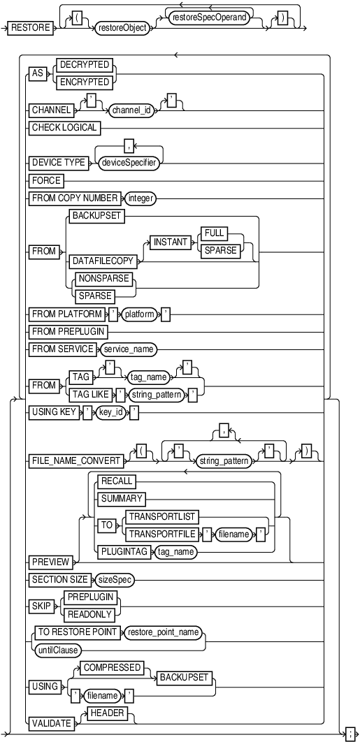

Syntax
(restoreObject::=, restoreSpecOperand::=, deviceSpecifier::=, untilClause::=)
(archivelogRecordSpecifier::=, datafileSpec::=, foreignFileSpec::=)

RMAN identifies which backup sets, data file copies, and archived redo log files must be restored, and then validates them (see Example 3-32). No files are restored. For files on both disk and tape, RMAN reads all blocks in the backup piece or image copy. RMAN also validates offsite backups. The validation is identical to a real restore operation except that RMAN does not write output files. Note: If you use See Also: |
Reports and validates—but does not restore—the backups that RMAN could use to restore to the specified time. When you specify this option, RMAN performs the same functions as when you run See Also: The descriptions of the |

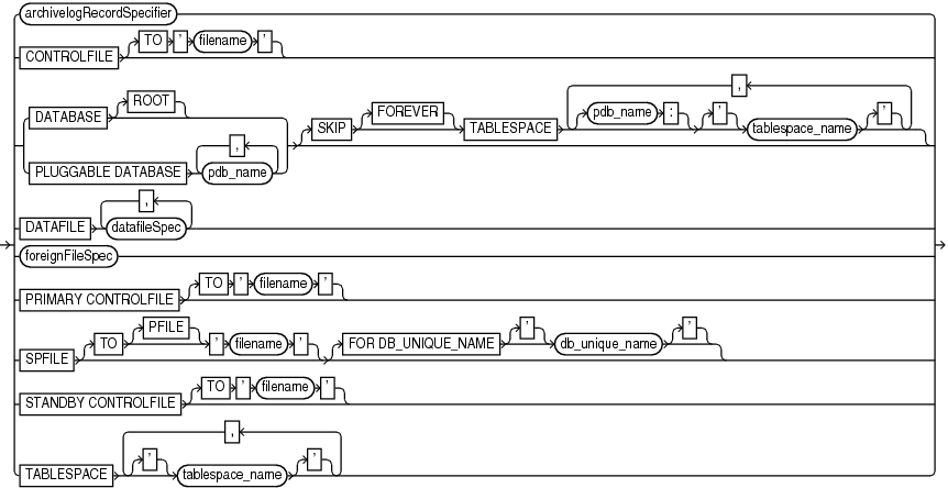

restoreObject
This subclause specifies the objects to be restored: control files, data files, archived redo log files, or the server parameter file. RMAN does not support backup and recovery of the change tracking file. RMAN re-creates the change tracking file after database restore and recovery; the next incremental backup after any recovery can use the file. Thus, restore and recovery has no user-visible effect on change tracking.
| Syntax Element | Description |
Restores the specified range of archived redo log files. The default restore location is Because the
Note: The database can be started, mounted, or open for this operation. See Also: |
Restores either a standby or backup control file depending on the target database role. If the control file is lost, then restore the control file (see Table 3-9) and restore the database after mounting the restored control file. You must always run the Note: If the target database is not mounted, and if RMAN is not connected to a recovery catalog, then you must specify the When you run |
Restores the control file to the specified file name. Table 3-9 explains RMAN behavior when restoring the control file with the |
APPLICATION ROOT DATABASE |
Specifies all data files in the application root. Connect to the CDB root as a common user with the |
Restores all data files in the a whole CDB or a PDB, except those that are offline.
By default, RMAN restores data files in read-only tablespaces. To restore data
files in a CDB, connect to the root as a common user with the
In an application container, restores the entire application container. This includes the application root and all application PDBs that belong to this application root. You connect to the application root as an application common user with the Unlike Note: To restore offline data files you must use |
Restores all online data files belonging to the root. Connect to the root as a
common user with the In an application container, restores online data files belonging to the application root and all application PDBs. Connect to the application root as an application common user with the |
Restores all data files belonging to the specified PDB. No other PDBs are affected;
they can remain open and operational. Use a comma-separated list to restore
multiple PDBs. Connect to the root as common user with the In an application container, connect to the CDB root as a common user with the To restore all data files belonging to a specified application PDB, connect to the application root as an application common user with the |
SKIP [FOREVER] TABLESPACE tablespace_name |
Excludes the specified tablespaces from the restore operation. This option is useful to avoid restoring tablespaces containing temporary data. In a CDB, refers to a tablespace in the root when connected to the root, and refers to a tablespace in a PDB when connected directly to the PDB. Specifying the |
Excludes the specified tablespaces in the named PDB from the restore operation. This
syntax is required only when connected to the root. When connected directly to a
PDB, use |
In a CDB, restores all data files belonging to the specified PDB. No other PDBs are affected; they can remain open and operational. Use a comma separated list to restore multiple PDBs. Connect to the root as described in CONNECT. This syntax is required only when connected to the root. When connected directly to a PDB, use |
Restores the data files specified by file name or absolute data file number (see Example 3-24). Note: Do not specify a data file more than once in a restore job. For example, the following command is invalid because data file 1 is both specified explicitly and implied by the RESTORE TABLESPACE SYSTEM DATAFILE 1; See Also: |
Restores a cross-platform backup that uses backup sets. Specifying Use the To plug the restored tablespaces in to the destination database, you use the export dump file containing the tablespace metadata that was created along with the backup. Use Note: This clause can be used only to restore data that was backed up using backup sets. It cannot be used for backups created as image copies. See Also: |
Restores a control file for a primary database in a Data Guard environment. RMAN restores either a normal or standby control file as appropriate, depending on the most recent database role known to the recovery catalog ( Assume that you perform a switchover from primary database |
Restores a primary or standby server parameter file to the location from which it was backed up. RMAN cannot overwrite a server parameter file currently in use by the target database. By default RMAN restores the most current server parameter file. Specify the If the server parameter file is lost, then connect RMAN to the target database (and recovery catalog if used) and run Note: If the target database is not mounted, and if RMAN is not connected to a recovery catalog, then you must specify the |
Restores a primary or standby server parameter file to the location specified by the |
FOR DB_UNIQUE_NAME db_unique_name |
Specifies the When In a Data Guard environment, the primary and standby hosts may have different channel configurations for communicating with their associated SBT backup and disk devices. If both the primary and standby databases are known to the recovery catalog, then the configuration settings for both databases are recorded in the recovery catalog. Because the two databases have the same Note: Using See Also: Oracle Data Guard Concepts and Administration for a detailed procedure for restoring the server parameter file in a Data Guard environment |
Restores the standby control file to the specified file name. Table 3-9 explains the RMAN behavior when restoring the control file with the |
Restores a control file for a standby database. RMAN can transparently restore a normal control file backup and make it usable for a standby database. RMAN restores either a normal or standby control file as appropriate, depending on the most recent database role known to the recovery catalog ( If you restore the control file of a database whose See Also: Table 3-9 for restrictions and usage notes Note: You must always run the |
Restores all data files in the specified tablespaces (see Example 3-23). RMAN translates the tablespace name internally into a list of data files. If you rename a tablespace (for example, from Note: RMAN can back up and restore dictionary-managed temporary tablespaces, but it cannot back up locally managed temporary tablespaces. However, RMAN automatically re-creates locally managed temporary tablespaces after restoring the database. |

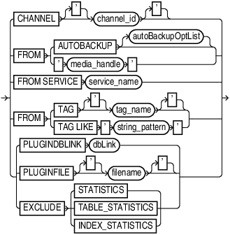

restoreSpecOperand
This subclause specifies options for the restoreObject clause. These parameters override the parameters with the same name at the RESTORE command level.
Specifies the case-sensitive name of a channel to use for this restore operation. If you do not specify a channel, then |
Restores a control file autobackup (see Example 3-26). This option is only valid on the RMAN begins the search on the current day or on the day specified with the See Also: Table 3-9 for restrictions and usage notes. |
Specifies parameters that control the search for a control file autobackup. |
Specifies the name of the control file copy or backup piece containing a control file. The See Also: Table 3-9 for restrictions and usage notes. |
Restores data files or control files using backups transferred, over the network, from the remote database. |
Overrides the default selection of the most recent backups or file copy available. The tag restricts the automatic selection to backup sets or file copies created with the specified tag. If multiple backup sets or copies have a matching tag, then RMAN selects the most recent one. Tag names are not case sensitive. See Also: |
Specifies the public database link created on a destination database to which a PDB or tablespace is being transported. When you use regular RMAN backups to transport a PDB or tablespace over the network to a destination database, RMAN requires the dbLink to transport the export dump file or the PDB unplug XML file from the source database to the destination database. You must use the After you create the See, Backup and Recovery User's Guide to learn about transporting PDBs and tablespaces over the network. |
Stores the structural metadata of a PDB or tablespace in the location specified by Starting with Oracle AI Database 26ai, specify the If you are transporting a PDB, then use the If you omit the See, Backup and Recovery User's Guide to learn how you can use regular RMAN backups to transport PDBs and tablespaces over the network. |

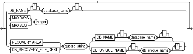

autoBackupOptList
This subclause specifies parameters that control the search for a control file autobackup.
Provides a The default value of the |
Limits the search for a control file autobackup to within the specified number of days earlier. |
Specifies the highest sequence number for the control file autobackup search. |
Specifies a path to the fast recovery area to search for autobackups. |
DB_RECOVERY_FILE_DEST 'pathname' |
DB_NAME database_name |
Specifies the The default value of the |
