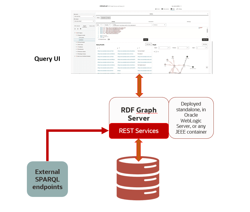

The following figure shows the RDF Graph Server and Query UI architecture:
Figure: RDF Graph Server and Query UI
The Oracle RDF Graph Query UI is an Oracle JET based client that can be used to manage RDF objects from different data sources, and to perform SPARQL queries and updates. This Java EE application helps to build application web pages that query and display RDF graphs. It supports queries across multiple data sources. The salient features of the RDF Graph Query UI are as follows:
