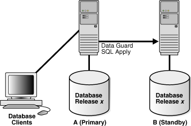

Figure 13-1 shows an Oracle Data Guard configuration before the upgrade begins, with the primary and logical standby databases both running the same Oracle Database software release.
Figure 13-1 Oracle Data Guard Configuration Before Upgrade
Description of "Figure 13-1 Oracle Data Guard Configuration Before Upgrade"

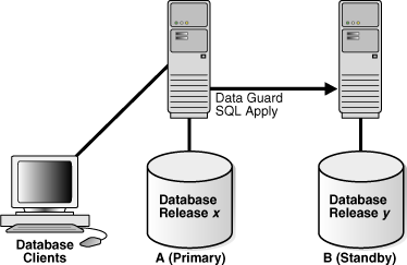

Figure 13-2 shows Database A running release x, and Database B running release y. During the upgrade, redo data accumulates on the primary system.
Figure 13-2 Upgrade the Logical Standby Database Release
Description of "Figure 13-2 Upgrade the Logical Standby Database Release" -

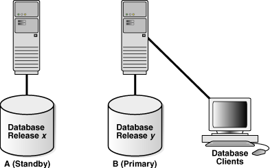

Activate the user applications and services on Database B, which is now running in the primary database role.
After the switchover, you cannot send redo data from the new primary database (B) that is running the new database software release to the new standby database (A) that is running an older software release. This means the following:
Redo data is accumulating on the new primary database.
The new primary database is unprotected at this time.
Figure 13-4 shows Database B, the former standby database (running release y), is now the primary database, and Database A, the former primary database (running release x), is now the standby database. The users are connected to Database B.

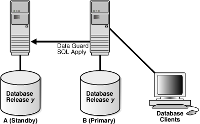

Figure 13-5 shows the system after both databases have been upgraded.
