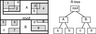

For a layer of geometries, an R-tree index consists of a hierarchical index on the MBRs of the geometries in the layer, as shown in Figure: R-Tree Hierarchical Index on MBRs.
In Figure: R-Tree Hierarchical Index on MBRs:
1 through 9 are geometries in a layer.
a, b, c, and d are the leaf nodes of the R-tree index, and contain minimum bounding rectangles of geometries, along with pointers to the geometries. For example, a contains the MBR of geometries 1 and 2, b contains the MBR of geometries 3 and 4, and so on.
A contains the MBR of a and b, and B contains the MBR of c and d.
The root contains the MBR of A and B (that is, the entire area shown).
