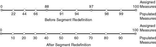

Redefining a Geometric Segment
You can redefine a geometric segment to replace the existing measures of all shape points between the start and end point with automatically calculated measures. Redefining a segment can be useful if errors have been made in one or more explicit measure assignments, and you want to start over with proportionally assigned measures. Figure: Redefining a Geometric Segment shows the redefinition of a segment where the existing (before) assigned measure values are not proportional and reflect widely varying gaps.
After the segment redefinition in Figure: Redefining a Geometric Segment, the populated measures reflect proportional distances along the segment.

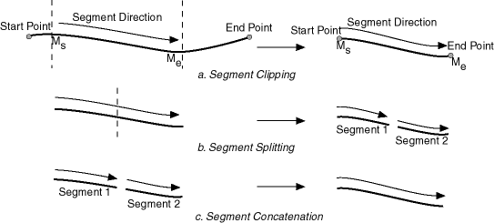

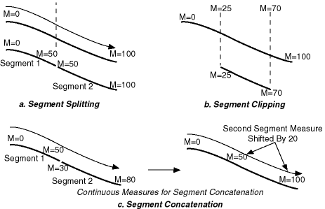

Clipping a Geometric Segment (Dynamic Segmentation)
You can clip a geometric segment to create a new geometric segment out of an existing geometric segment, as shown in Figure: Clipping, Splitting, and Concatenating Geometric Segments, part a.
In Figure: Clipping, Splitting, and Concatenating Geometric Segments, part a, a segment is created from part of a larger segment. The new segment has its own start and end points, and the direction is the same as in the original larger segment.
Clipping segments enables you to perform dynamic segmentation, where you clip the line at specific measure values. A scenario for such usage would be creating a table of road conditions, where for a given road, some segments are designated as in good condition and other segments are designated as in bad condition. For example, the segment between measures 100 and 120 might be in good condition, but the segment between measures 120 and 125 might be in poor condition. See the reference information for the synonymous functions SDO_LRS.CLIP_GEOM_SEGMENT and SDO_LRS.DYNAMIC_SEGMENT.
Splitting a Geometric Segment
You can create two new geometric segments by splitting a geometric segment, as shown in the figure in Clipping a Geometric Segment (Dynamic Segmentation), part b. The direction of each new segment is the same as in the original segment.
Note: In Clipping a Geometric Segment (Dynamic Segmentation) and other topics, small gaps between segments are used in illutrations of segment splitting and concatenation. Each gap simply reinforces the fact that two different segments are involved. However, the two segments (such as segment 1 and segment 2 in Clipping a Geometric Segment (Dynamic Segmentation), parts b and c) are actually connected. The tolerance (see Tolerance) is considered in determining whether or not segments are connected.
You can create a new geometric segment by concatenating two geometric segments, as shown in part c of the figure in Clipping a Geometric Segment (Dynamic Segmentation). The geometric segments do not need to be spatially connected, although they are connected in the illustration in part c of that figure. (If the segments are not spatially connected, the concatenated result is a multiline string.) The measures of the second geometric segment are shifted so that the end measure of the first segment is the same as the start measure of the second segment. The direction of the segment resulting from the concatenation is the same as in the two original segments.
Measure assignments for the clipping, splitting, and concatenating operations in the figure in Clipping a Geometric Segment (Dynamic Segmentation) are shown in the following figure. Measure information and segment direction are preserved in a consistent manner. The assignment is done automatically when the operations have completed.
Figure: Measure Assignment in Geometric Segment Operations

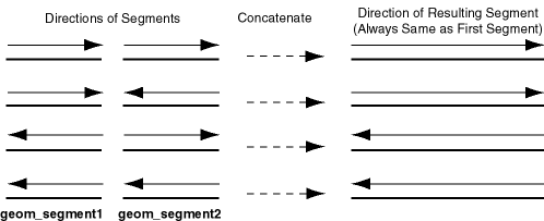

The direction of the geometric segment resulting from concatenation is always the direction of the first segment (geom_segment1 in the call to the SDO_LRS.CONCATENATE_GEOM_SEGMENTS function), as shown in the following figure.
Figure: Segment Direction with Concatenation

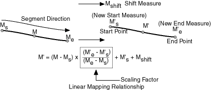

Scaling a Geometric Segment
You can create a new geometric segment by performing a linear scaling operation on a geometric segment. Figure: Scaling a Geometric Segment shows the mapping relationship for geometric segment scaling.
In general, scaling a geometric segment only involves rearranging measures of the newly created geometric segment. However, if the scaling factor is negative, the order of the shape points needs to be reversed so that measures will increase along the geometric segment’s direction (which is defined by the order of the shape points).
A scale operation can perform any combination of the following operations:
Translating (shifting) measure information. (For example, add the same value to Ms and Me to get M’s and M’e.)
Reversing measure information. (Let M’s = Me, M’e = Ms, and Mshift = 0.)
Performing simple scaling of measure information. (Let Mshift = 0.)
For examples of these operations, see the Usage Notes and Examples for the SDO_LRS.SCALE_GEOM_SEGMENT, SDO_LRS.TRANSLATE_MEASURE, SDO_LRS.REVERSE_GEOMETRY, and SDO_LRS.REDEFINE_GEOM_SEGMENT subprograms in SDO_LRS Package (Linear Referencing System).

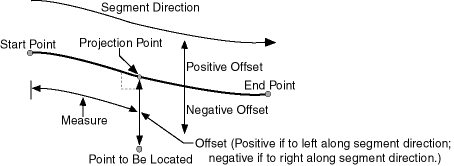

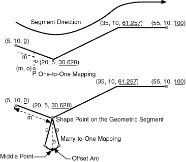

Locating a Point on a Geometric Segment
You can find the position of a point described by a measure and an offset on a geometric segment (see Figure: Locating a Point Along a Segment with a Measure and an Offset).
There is always a unique location with a specific measure on a geometric segment. Ambiguity arises when offsets are given and the points described by the measures fall on shape points of the geometric segment (see Figure: Ambiguity in Location Referencing with Offsets).
As shown in Figure: Ambiguity in Location Referencing with Offsets, an offset arc of a shape point on a geometric segment is an arc on which all points have the same minimum distance to the shape point. As a result, all points on the offset arc are represented by the same (measure, offset) pair. To resolve this one-to-many mapping problem, the middle point on the offset arc is returned.

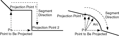

Projecting a Point onto a Geometric Segment
You can find the projection point of a point with respect to a geometric segment. The point to be projected can be on or off the segment. If the point is on the segment, the point and its projection point are the same.
Projection is a reverse operation of the point-locating operation shown in Figure: Locating a Point Along a Segment with a Measure and an Offset. Similar to a point-locating operation, all points on the offset arc of a shape point will have the same projection point (that is, the shape point itself), measure, and offset (see Figure: Ambiguity in Location Referencing with Offsets). If there are multiple projection points for a point, the first one from the start point is returned (Projection Point 1 in both illustrations in Figure: Multiple Projection Points).
