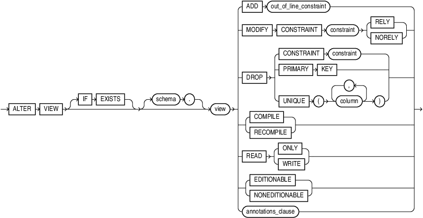

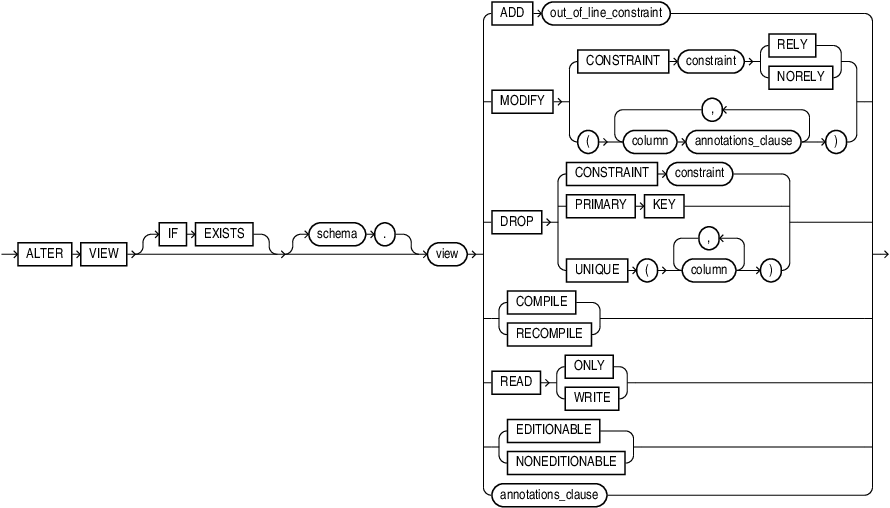

alter_view::=
(out_of_line_constraint::=—part of constraint::= syntax), annotations_clause
