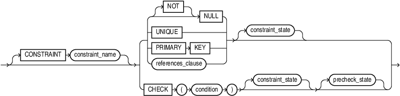

inline_constraint::=
(references_clause::=)

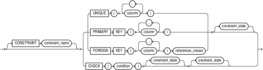

out_of_line_constraint::=
(references_clause::=, constraint_state::=)

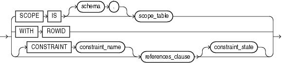

inline_ref_constraint::=

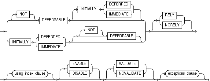

constraint_state::=
(using_index_clause::=, exceptions_clause::=)

NOT NULL Constraints
A NOT NULL constraint prohibits a column from containing nulls. The NULL keyword by itself does not actually define an integrity constraint, but you can specify it to explicitly permit a column to contain nulls. You must define NOT NULL and NULL using inline specification. If you specify neither NOT NULL nor NULL, then the default is NULL.
NOT NULL constraints are the only constraints you can specify inline on XMLType and VARRAY columns.
To satisfy a NOT NULL constraint, every row in the table must contain a value for the column.
Note: The database does not index table rows in which all key columns are null except in the case of bitmap indexes. Therefore, if you want an index on all rows of a table, then you must either specify NOT NULL constraints for at least one of the index key columns or create a bitmap index.
Restrictions on NOT NULL Constraints
NOT NULL constraints are subject to the following restrictions:
See Also: “Attribute-Level Constraints Example” and “NOT NULL Example”
Unique Constraints
A unique constraint designates a column as a unique key. A composite unique key designates a combination of columns as the unique key. When you define a unique constraint inline, you need only the UNIQUE keyword. When you define a unique constraint out of line, you must also specify one or more columns. You must define a composite unique key out of line.
To satisfy a unique constraint, no two rows in the table can have the same value for the unique key. However, the unique key made up of a single column can contain nulls. To satisfy a composite unique key, no two rows in the table or view can have the same combination of values in the key columns. Any row that contains nulls in all key columns automatically satisfies the constraint. However, two rows that contain nulls for one or more key columns and the same combination of values for the other key columns violate the constraint.
Unique constraints are sensitive to declared collations of their key columns. See Collation Sensitivity of Constraints for more details.
When you specify a unique constraint on one or more columns, the database implicitly creates an index on the unique key. If you are defining uniqueness for purposes of query performance, then the database recommends that you instead create the unique index explicitly using a CREATE UNIQUE INDEX statement. You can also use the CREATE UNIQUE INDEX statement to create a unique function-based index that defines a conditional unique constraint. See “Using a Function-based Index to Define Conditional Uniqueness: Example” for more information.
When you specify an enabled unique constraint on an extended data type column, you may receive a “maximum key length exceeded” error when the database tries to create the index to enforce uniqueness for the enabled constraint. See “Creating an Index on an Extended Data Type Column” for information on how to work around this issue.
Restrictions on Unique Constraints
Unique constraints are subject to the following restrictions:
See Also: “Unique Key Example” and Composite Unique Key Example
Primary Key Constraints
A primary key constraint designates a column as the primary key of a table or view. A composite primary key designates a combination of columns as the primary key. When you define a primary key constraint inline, you need only the PRIMARY KEY keywords. When you define a primary key constraint out of line, you must also specify one or more columns. You must define a composite primary key out of line.
To satisfy a primary key constraint:
When you create a primary key constraint:
When you drop a primary key constraint:
When you designate an extended data type column as an enabled primary key, you may receive a “maximum key length exceeded” error when the database tries to create the index to enforce uniqueness for the enabled constraint. See “Creating an Index on an Extended Data Type Column” for information on how to work around this issue.
Primary key constraints are sensitive to declared collations of their key columns. See Collation Sensitivity of Constraints for more details.
Restrictions on Primary Key Constraints
Primary constraints are subject to the following restrictions:
See Also: “Primary Key Example” and “Composite Primary Key Example”
Foreign Key Constraints
A foreign key constraint (also called a referential integrity constraint) designates a column as the foreign key and establishes a relationship between that foreign key and a specified primary or unique key, called the referenced key. A composite foreign key designates a combination of columns as the foreign key.
The table or view containing the foreign key is called the child object, and the table or view containing the referenced key is called the parent object. The foreign key and the referenced key can be in the same table or view. In this case, the parent and child tables are the same. If you identify only the parent table or view and omit the column name, then the foreign key automatically references the primary key of the parent table or view. The corresponding column or columns of the foreign key and the referenced key must match in order, data types, and declared collations.
Foreign key constraints are sensitive to declared collations of the referenced primary or unique key columns. See Collation Sensitivity of Constraints for more details.
You can define a foreign key constraint on a single key column either inline or out of line. You must specify a composite foreign key and a foreign key on an attribute out of line.
To satisfy a composite foreign key constraint, the composite foreign key must refer to a composite unique key or a composite primary key in the parent table or view, or the value of at least one of the columns of the foreign key must be null.
You can designate the same column or combination of columns as both a foreign key and a primary or unique key. You can also designate the same column or combination of columns as both a foreign key and a cluster key.
You can define multiple foreign keys in a table or view. Also, a single column can be part of more than one foreign key.
Restrictions on Foreign Key Constraints
Foreign key constraints are subject to the following restrictions:
See Also:
references_clause
Foreign key constraints use the references_clause syntax. When you specify a foreign key constraint inline, you need only the references_clause. When you specify a foreign key constraint out of line, you must also specify the FOREIGN KEY keywords and one or more columns.
ON DELETE Clause
The ON DELETE clause lets you determine how the database automatically maintains referential integrity if you remove a referenced primary or unique key value. If you omit this clause, then the database does not allow you to delete referenced key values in the parent table that have dependent rows in the child table.
Restriction on ON DELETE
You cannot specify this clause for a view constraint.
See Also: “ON DELETE Example”

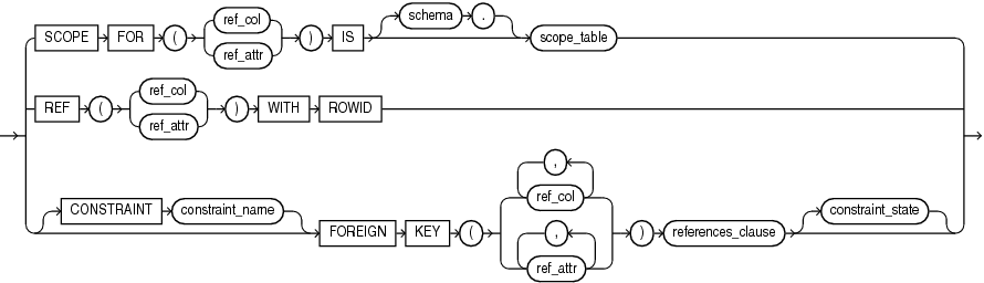

REF constraints let you describe the relationship between a column of type REF and the object it references.
ref_constraint
REF constraints use the ref_constraint syntax. You define a REF constraint either inline or out of line. Out-of-line specification requires you to specify the REF column or attribute you are further describing.
Both inline and out-of-line specification let you define a scope constraint, a rowid constraint, or a referential integrity constraint on a REF column.
If the scope table or referenced table of the REF column has a primary-key-based object identifier, then the REF column is a user-definedREFcolumn.
See Also:
SCOPE REF Constraints
In a table with a REF column, each REF value in the column can conceivably reference a row in a different object table. The SCOPE clause restricts the scope of references to a single table, scope_table. The values in the REF column or attribute point to objects in scope_table, in which object instances of the same type as the REF column are stored.
Specify the SCOPE clause to restrict the scope of references in the REF column to a single table. For you to specify this clause, scope_table must be in your own schema, or you must have the READ or SELECT privilege on scope_table, or you must have the READ ANY TABLE or SELECT ANY TABLE system privilege. You can specify only one scope table for each REF column.
Restrictions on Scope Constraints
Scope constraints are subject to the following restrictions:
Rowid REF Constraints
Specify WITH ROWID to store the rowid along with the REF value in ref_columnor ref_attribute. Storing the rowid with the REF value can improve the performance of dereferencing operations, but will also use more space. Default storage of REF values is without rowids.
See Also: The function DEREF for an example of dereferencing
Restrictions on Rowid Constraints
Rowid constraints are subject to the following restrictions:
Referential Integrity Constraints on REF Columns
The references_clause of the ref_constraint syntax lets you define a foreign key constraint on the REF column. This clause also implicitly restricts the scope of the REF column or attribute to the referenced table. However, whereas a foreign key constraint on a non-REF column references an actual column in the parent table, a foreign key constraint on a REF column references the implicit object identifier column of the parent table.
If you do not specify a constraint name, then the database generates a system name for the constraint of the form SYS_Cn.
If you add a referential integrity constraint to an existing REF column that is already scoped, then the referenced table must be the same as the scope table of the REF column. If you later drop the referential integrity constraint, then the REF column will remain scoped to the referenced table.
As is the case for foreign key constraints on other types of columns, you can use the references_clause alone for inline declaration. For out-of-line declaration you must also specify the FOREIGN KEY keywords plus one or more REF columns or attributes.

Specifying Constraint State
You can specify how and when the database should enforce the constraint when you define the constraint.
constraint_state
You can use constraint_state with both inline and out-of-line specification. Except for the clauses DEFERRABLE and INITIALLY, that may be specified in any order, you must specify the rest of the component clauses in the order shown, and each clause only once.
DEFERRABLE Clause
The DEFERRABLE and NOT DEFERRABLE parameters indicate whether or not, in subsequent transactions, constraint checking can be deferred until the end of the transaction using the SET CONSTRAINT(S) statement. If you omit this clause, then the default is NOT DEFERRABLE.
Note: The optimizer does not consider indexes on deferrable constraints as usable.
You cannot alter the deferrability of a constraint. Whether you specify either of these parameters, or make the constraint NOT DEFERRABLE implicitly by specifying neither of them, you cannot specify this clause in an ALTER TABLE statement. You must drop the constraint and re-create it.
See Also:
Restriction on [NOT] DEFERRABLE
You cannot specify either of these parameters for a view constraint.
INITIALLY Clause
The INITIALLY clause establishes the default checking behavior for constraints that are DEFERRABLE. The INITIALLY setting can be overridden by a SET CONSTRAINT(S) statement in a subsequent transaction.
This clause is not valid if you have declared the constraint to be NOT DEFERRABLE, because a NOT DEFERRABLE constraint is automatically INITIALLY IMMEDIATE and cannot ever be INITIALLY DEFERRED.
RELY Clause
The RELY and NORELY parameters specify whether a constraint in NOVALIDATE mode is to be taken into account for query rewrite. Specify RELY to activate a constraint in NOVALIDATE mode for query rewrite in an unenforced query rewrite integrity mode. The constraint is in NOVALIDATE mode, so the database does not enforce it. The default is NORELY.
Unenforced constraints are generally useful only with materialized views and query rewrite. Depending on the QUERY_REWRITE_INTEGRITY mode, query rewrite can use only constraints that are in VALIDATE mode, or that are in NOVALIDATE mode with the RELY parameter set, to determine join information.
Restriction on the RELY Clause
You cannot set a nondeferrable NOT NULL constraint to RELY.
See Also: Oracle Database Data Warehousing Guide for more information on materialized views and query rewrite

using_index_clause
You can specify the using_index_clause only when enabling unique or primary key constraints. You can specify the clauses of the using_index_clause in any order, but you can specify each clause only once.
Restrictions on the using_index_clause
The following restrictions apply to the using_index_clause:
See Also:
ENABLE Clause
Specify ENABLE if you want the constraint to be applied to the data in the table.
If you enable a unique or primary key constraint, and if no index exists on the key, then the database creates a unique index. Unless you specify KEEP INDEX when subsequently disabling the constraint, this index is dropped and the database rebuilds the index every time the constraint is reenabled.
You can also avoid rebuilding the index and eliminate redundant indexes by creating new primary key and unique constraints initially disabled. Then create (or use existing) nonunique indexes to enforce the constraint. The database does not drop a nonunique index when the constraint is disabled, so subsequent ENABLE operations are facilitated.
If you specify neither VALIDATE nor NOVALIDATE, then the default is VALIDATE.
If you change the state of any single constraint from ENABLE NOVALIDATE to ENABLE VALIDATE, then the operation can be performed in parallel, and does not block reads, writes, or other DDL operations.
Restriction on the ENABLE Clause
You cannot enable a foreign key that references a disabled unique or primary key.
DISABLE Clause
Specify DISABLE to disable the integrity constraint. Disabled integrity constraints appear in the data dictionary along with enabled constraints. If you do not specify this clause when creating a constraint, then the database automatically enables the constraint.
See Also: Oracle Database Data Warehousing Guide for more information on using this setting
See Also: Oracle Database SQL Tuning Guide for information on when to use this setting
If you specify neither VALIDATE nor NOVALIDATE, then the default is NOVALIDATE.
If you disable a unique or primary key constraint that is using a unique index, then the database drops the unique index. Refer to the CREATE TABLE enable_disable_clause for additional notes and restrictions.
VALIDATE | NOVALIDATE
The behavior of VALIDATE and NOVALIDATE depends on whether the constraint is enabled or disabled, either explicitly or by default. Therefore, the VALIDATE and NOVALIDATE keywords are described in the context of “ENABLE Clause” and “DISABLE Clause”.
Note on Foreign Key Constraints in NOVALIDATE Mode
When a foreign key constraint is in NOVALIDATE mode, if existing data in the table does not comply with the constraint and the QUERY_REWRITE_INTEGRITY parameter is not set to ENFORCED, then the optimizer may use join elimination during queries on the table. In this case, a query may return table rows with noncompliant foreign key values even if the query contains a join condition that should filter out those rows.
Handling Constraint Exceptions
When defining the state of a constraint, you can specify a table into which the database places the rowids of all rows violating the constraint.
exceptions_clause
Use the exceptions_clause syntax to define exception handling. If you omit schema, then the database assumes the exceptions table is in your own schema. If you omit this clause altogether, then the database assumes that the table is named EXCEPTIONS. The EXCEPTIONS table or the table you specify must exist on your local database.
You can create the EXCEPTIONS table using one of these scripts:
If you create your own exceptions table, then it must follow the format prescribed by one of these two scripts.
If you are collecting exceptions from index-organized tables based on primary keys (rather than universal rowids), then you must create a separate exceptions table for each index-organized table to accommodate its primary-key storage. You create multiple exceptions tables with different names by modifying and resubmitting the script.
Restrictions on the exceptions_clause
The following restrictions apply to the exceptions_clause:

REF Constraint Examples
The following example creates a duplicate of the sample schema object type cust_address_typ, and then creates a table containing a REF column with a SCOPE constraint:
CREATE TYPE cust_address_typ_new AS OBJECT
    ( street_address     VARCHAR2(40)
    , postal_code        VARCHAR2(10)
    , city               VARCHAR2(30)
    , state_province     VARCHAR2(10)
    , country_id         CHAR(2)
CREATE TABLE address_table OF cust_address_typ_new;
CREATE TABLE customer_addresses (
   add_id NUMBER,
   address REF cust_address_typ_new
   SCOPE IS address_table);
The following example creates the same table but with a referential integrity constraint on the REF column that references the object identifier column of the parent table:
   add_id NUMBER,
   address REF cust_address_typ REFERENCES address_table);
The following example uses the type department_typ and the table departments_obj_t, created in “Creating Object Tables: Examples”. A table with a scoped REF is then created.
CREATE TABLE employees_obj
   ( e_name   VARCHAR2(100),
     e_number NUMBER,
     e_dept   REF department_typ SCOPE IS departments_obj_t );
The following statement creates a table with a REF column which has a referential integrity constraint defined on it:
     e_number NUMBER,
     e_dept   REF department_typ REFERENCES departments_obj_t);
Explicit Index Control Example
The following statement shows another way to create a unique (or primary key) constraint that gives you explicit control over the index (or indexes) the database uses to enforce the constraint:
CREATE TABLE promotions_var3
    ( promo_id         NUMBER(6)
    , promo_name       VARCHAR2(20)
    , promo_category   VARCHAR2(15)
    , promo_cost       NUMBER(10,2)
    , promo_begin_date DATE
    , promo_end_date   DATE
    , CONSTRAINT promo_id_u UNIQUE (promo_id, promo_cost)
         USING INDEX (CREATE UNIQUE INDEX promo_ix1
            ON promotions_var3 (promo_id, promo_cost))
    , CONSTRAINT promo_id_u2 UNIQUE (promo_cost, promo_id)
         USING INDEX promo_ix1);
This example also shows that you can create an index for one constraint and use that index to create and enable another constraint in the same statement.
DEFERRABLE Constraint Examples
The following statement creates table games with a NOT DEFERRABLE INITIALLY IMMEDIATE constraint check (by default) on the scores column:
CREATE TABLE games (scores NUMBER CHECK (scores >= 0));
To define a unique constraint on a column as INITIALLY DEFERRED DEFERRABLE, issue the following statement:
CREATE TABLE games
  (scores NUMBER, CONSTRAINT unq_num UNIQUE (scores)
   INITIALLY DEFERRED DEFERRABLE);
