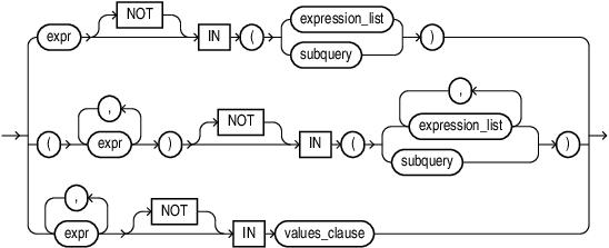

An in_condition is a membership condition. It tests a value for membership in a list of values or subquery
in_condition::=
If you use the upper form of the in_condition condition (with a single expression to the left of the operator), then you must use the upper form of expression_list. If you use the lower form of this condition (with multiple expressions to the left of the operator), then you must use the lower form of expression_list, and the expressions in each expression_list must match in number and data type the expressions to the left of the operator. You can specify up to 65535 expressions in expression_list.
