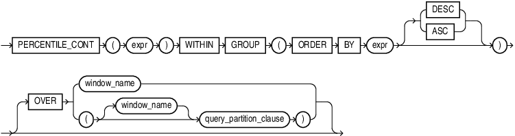

PERCENTILE_CONT
Syntax
See Also:Analytic Functions” for information on syntax, semantics, and restrictions of the OVER clause
