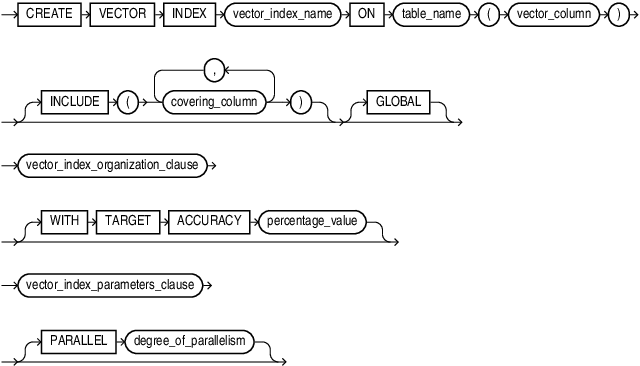

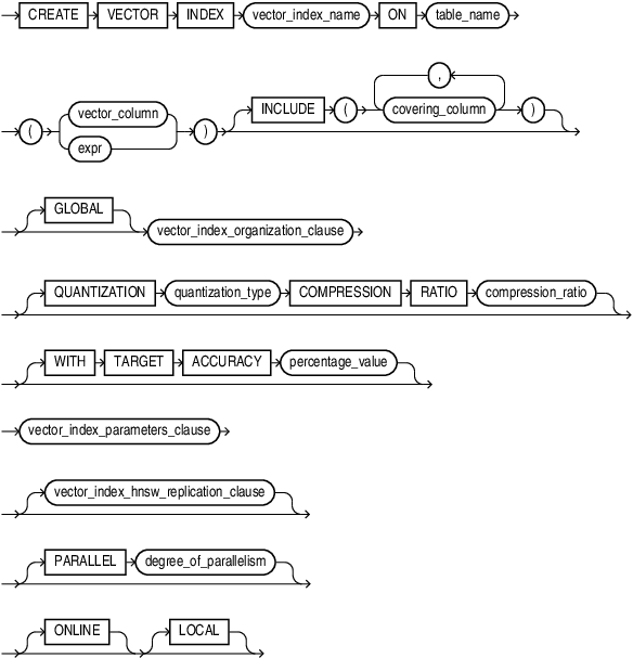

Syntax
(vector_index_organization_clause::=,vector_index_parameters_clause::=,vector_index_hnsw_replication_clause,)
