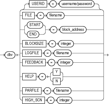

25.1.1 DBVERIFY Syntax When Validating Blocks of a Single File
See the syntax for using DBVERIFY to validate blocks of a single file.
The syntax for DBVERIFY when you want to validate disk blocks of a single data file is as follows:
25.1.2 DBVERIFY Parameters When Validating Blocks of a Single File
See the DBVERIFY parameters that you can use to validate blocks of a single file.

25.1.3 Example DBVERIFY Output For a Single Data File
See an example of verification for a single data file, and how you can interpret it.
The following is an example verification of the file t_db1.dbf. The feedback parameter has been given the value 100 to display one period (.) for every 100 pages processed.
% dbv FILE=t_db1.dbf FEEDBACK=100
Output example
The output of this command is as follows:
DBVERIFY - Verification starting : FILE = t_db1.f
DBVERIFY - Verification complete
Total Pages Examined : 120424
Total Pages Processed (Data) : 79507
Total Pages Failing (Data) : 0
Total Pages Processed (Index): 15236
Total Pages Failing (Index): 0
Total Pages Processed (Other): 5626
Total Pages Processed (Seg) : 1
Total Pages Failing (Seg) : 0
Total Pages Empty : 20055
Total Pages Marked Corrupt : 0
Total Pages Influx : 0
Total Pages Encrypted : 0
Highest block SCN : 25565681 (0.25565681)
Notes
  • Pages = Blocks
  • Total Pages Examined = number of blocks in the file.
  • Total Pages Processed (Data) = number of blocks that were verified (formatted blocks).
  • Total Pages Processed (Other) = metadata blocks. These blocks are not being verified, so there is no output for "Total Pages Failing (Other)."
  • Total Pages Processed (Seg) = number of segment header blocks.
  • Total Pages Failing (Data) = number of blocks that failed the data block checking routine.
  • Total Pages Failing (Index) = number of blocks that failed the index block checking routine.
  • Total Pages Marked Corrupt = number of blocks for which the cache header is invalid, thereby making it impossible for DBVERIFY to identify the block type.
  • Total Pages Influx = number of blocks that are being read and written to at the same time. If the database is open when DBVERIFY is run, then DBVERIFY reads blocks multiple times to obtain a consistent image. But because the database is open, there can be blocks that are being read and written to at the same time (INFLUX). In that event, DBVERIFY cannot obtain a consistent image of pages that are in flux.
  • Total Pages Encrypted = all blocks (Data, Index, Other, Seg), not only Data or Index. When "Total Pages Encrypted" is different than zero, DBVERIFY outputs the message "DBVerify cannot perform logical check against encrypted blocks, RMAN should be used."

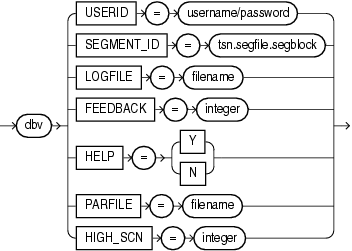

25.2.1 DBVERIFY Syntax When Validating a Segment
See the syntax for using DBVERIFY to validate a segment.
The syntax for DBVERIFY when you want to validate a segment is as follows:
25.2.2 DBVERIFY Parameters When Validating a Single Segment
See the DBVERIFY parameters that you can use to validate a single segment.

25.2.3 Example DBVERIFY Output For a Validated Segment
See an example of a verification for a validated segment.
The following is an example of using the DBVERIFY command with a tablespace segment, and the output produced by a DBVERIFY operation.
% dbv userid=system/ SEGMENT_ID=2.5.37767
DBVERIFY - Verification starting : SEGMENT_ID = 2.5.37767
Total Pages Examined : 640
Total Pages Processed (Data) : 0
Total Pages Processed (Index): 0
Total Pages Processed (Other): 591
Total Pages Processed (Seg) : 8
Total Pages Empty : 13
Total Pages Encrypted : 28
Highest block SCN : 7877587 (0.7877587)
