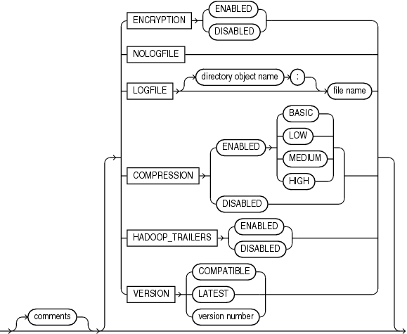

16.2 access_parameters Clause
When you create the ORACLE_DATAPUMP access driver external
table, you can specify certain parameters in an access_parameters clause.
This clause is optional, as are its individual parameters. For example,
you can specify LOGFILE, but not VERSION, or vice
versa. The syntax for the access_parameters clause is as
follows.
These access parameters are collectively referred to as the
opaque_format_spec in the SQL CREATE
TABLE...ORGANIZATION EXTERNAL statement.

16.2.6 HADOOP_TRAILERS Clause
The ORACLE_DATAPUMP access driver provides a
HADOOP_TRAILERS clause that specifies whether to write Hadoop trailers
to the dump file.
Default
DISABLEDPurpose
Specifies whether to write Hadoop trailers to the dump file.
Syntax and Description
HADOOP_TRAILERS [ENABLED|DISABLED]
When the HADOOP_TRAILERS clause is set to ENABLED,
Hadoop trailers are written to the dump file. Hadoop trailers include information
about locations and sizes of different parts of the file. The information is written
in a dump trailer block at the end of the file, and at the end of the stream data,
instead of at the beginning.
Parent topic: access_parameters Clause
