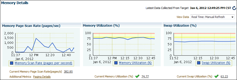

This page contains statistics about memory utilization, page scan rates, and swap utilization gathered over the last hour. The top 10 processes are also listed ordered by memory utilization. Figure 4-8 shows a portion of the Memory Details page. The Top 10 Processes (ordered by Memory) section is not shown.
Figure 8: Memory Details Page
Verify the current memory page scan rate using the Memory Page Scan Rate chart.
The current value of the memory page scan rate is displayed below the chart. On UNIX and Linux, this value represents the number of pages scanned per second. On Microsoft Windows, this value represents the rate at which pages are read from or written to disk to resolve hard page faults. This value is a primary indicator of the types of faults that may be causing system-wide delays.

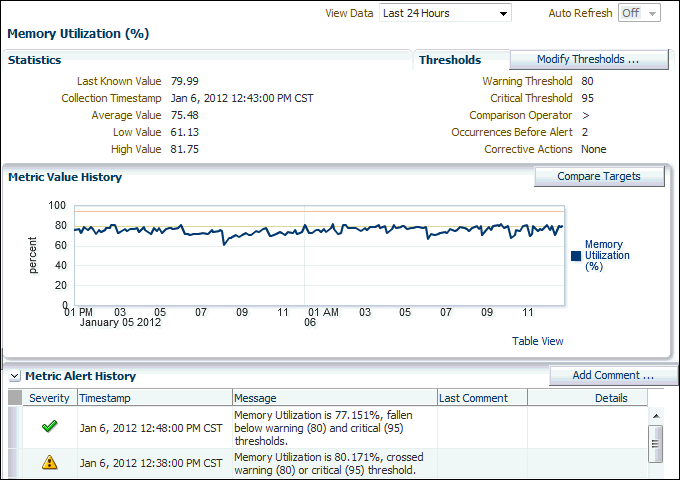

Using the Memory Utilization chart, verify the current memory utilization.
The Memory Utilization chart shows how much memory is being used. The current value of memory utilization is displayed below the chart. During standard workload hours, the value should not exceed the warning threshold (shown in yellow).
Click Memory Utilization (%).
The Memory Utilization page appears.
This page contains memory utilization statistics and related alerts generated over the last 24 hours.
In this example, memory utilization has exceeded 80%, so warnings appear in the Metric Alert History table.
If you notice an unexpected spike in this value that is sustained through normal workload hours, then a memory performance problem might exist.

Using the Swap Utilization chart, verify current swap utilization.
The Swap Utilization chart shows how much swap space is being used. The current value of swap utilization is displayed below the chart. During normal workload hours, the value should not exceed the warning threshold.
