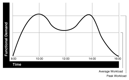

Workload is an important factor when evaluating your system's level of CPU utilization. During peak workload hours, 90% CPU utilization with 10% idle and waiting time can be acceptable. Even 30% utilization at a time of low workload can be understandable. However, if your system shows high utilization at normal workload, then there is no room for a peak workload. For example, The following figure illustrates workload over time for an application having peak periods at 10:00 AM and 2:00 PM.
Figure 20-1 Average Workload and Peak Workload
Description of "Figure 20-1 Average Workload and Peak Workload"
This example application has 100 users working 8 hours a day. Each user entering one transaction every 5 minutes translates into 9,600 transactions daily. Over an 8-hour period, the system must support 1,200 transactions an hour, which is an average of 20 transactions a minute. If the demand rate were constant, then you could build a system to meet this average workload.
However, usage patterns are not constant and in this context, 20 transactions a minute can be understood as merely a minimum requirement. If the peak rate you need to achieve is 120 transactions a minute, then you must configure a system that can support this peak workload.
For this example, assume that at peak workload, Oracle AI Database uses 90% of the CPU resource. For a period of average workload, then, Oracle AI Database uses no more than about 15% of the available CPU resource, as illustrated in the following equation:
20 tpm / 120 tpm * 90% = 15% of available CPU resource
