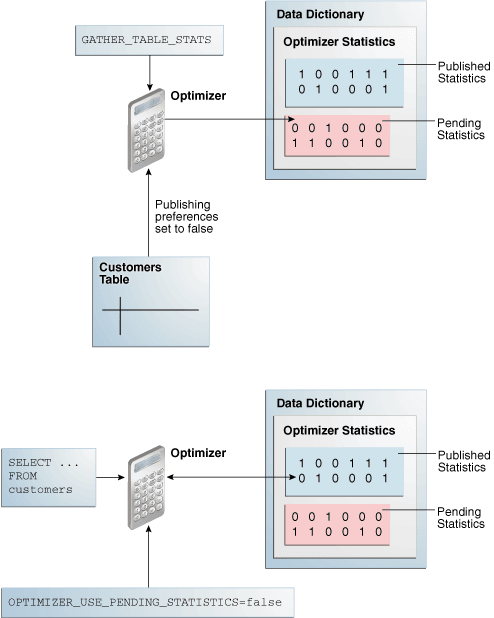

About Pending Optimizer Statistics
The database stores pending statistics in the data dictionary just as for published statistics.
By default, the optimizer uses published statistics. You can change the default behavior by setting the OPTIMIZER_USE_PENDING_STATISTICS initialization parameter to true (the default is false).
The top part of the following graphic shows the optimizer gathering statistics for the sh.customers table and storing them in the data dictionary with pending status. The bottom part of the diagram shows the optimizer using only published statistics to process a query of sh.customers.
Figure 15-1 Published and Pending Statistics
Description of "Figure 15-1 Published and Pending Statistics"
In some cases, the optimizer can use a combination of published and pending statistics. For example, the database stores both published and pending statistics for the customers table. For the orders table, the database stores only published statistics. If OPTIMIZER_USE_PENDING_STATS = true, then the optimizer uses pending statistics for customers and published statistics for orders. If OPTIMIZER_USE_PENDING_STATS = false, then the optimizer uses published statistics for customers and orders.
