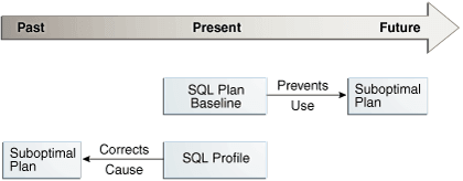

Differences Between SQL Plan Baselines and SQL Profiles
Both SQL profiles and SQL plan baselines help improve the performance of SQL statements by ensuring that the optimizer uses only optimal plans.
Both profiles and baselines are internally implemented using hints. However, these mechanisms have significant differences, including the following:
In general, SQL plan baselines are proactive, whereas SQL profiles are reactive.
Typically, you create SQL plan baselines before significant performance problems occur. SQL plan baselines prevent the optimizer from using suboptimal plans in the future.
The database creates SQL profiles when you invoke SQL Tuning Advisor, which you do typically only after a SQL statement has shown high-load symptoms. SQL profiles are primarily useful by providing the ongoing resolution of optimizer mistakes that have led to suboptimal plans. Because the SQL profile mechanism is reactive, it cannot guarantee stable performance as drastic database changes occur.
Figure 28-1 SQL Plan Baselines and SQL Profiles
Description of "Figure 28-1 SQL Plan Baselines and SQL Profiles" -
SQL plan baselines reproduce a specific plan, whereas SQL profiles correct optimizer cost estimates.
A SQL plan baseline is a set of accepted plans. Each plan is implemented using a set of outline hints that fully specify a particular plan. SQL profiles are also implemented using hints, but these hints do not specify any specific plan. Rather, the hints correct miscalculations in the optimizer estimates that lead to suboptimal plans. For example, a hint may correct the cardinality estimate of a table.
Because a profile does not constrain the optimizer to any one plan, a SQL profile is more flexible than a SQL plan baseline. For example, changes in initialization parameters and optimizer statistics enable the optimizer to choose a better plan.
Oracle recommends that you use SQL Tuning Advisor. In this way, you follow the recommendations made by the advisor for SQL profiles and plan baselines rather than trying to determine which mechanism is best for each SQL statement.

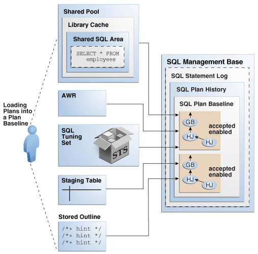

Manual Plan Capture
In SQL plan management, manual plan capture refers to the user-initiated bulk load of existing plans into a SQL plan baseline.
Use Cloud Control or PL/SQL to load the execution plans for SQL statements from AWR, a SQL tuning set (STS), the shared SQL area, a staging table, or a stored outline.
Figure 28-2 Loading Plans into a SQL Plan Baseline
Description of "Figure 28-2 Loading Plans into a SQL Plan Baseline"
The loading behavior varies depending on whether a SQL plan baseline exists for each statement represented in the bulk load:
If a baseline for the statement does not exist, then the database does the following:
Creates a plan history and plan baseline for the statement
Marks the initial plan for the statement as accepted
Adds the plan to the new baseline
If a baseline for the statement exists, then the database does the following:
Marks the loaded plan as accepted
Adds the plan to the plan baseline for the statement without verifying the plan's performance
Manually loaded plans are always marked accepted because the optimizer assumes that any plan loaded manually by the administrator has acceptable performance. You can load plans without enabling them by setting the enabled parameter to NO in the DBMS_SPM.LOAD_PLANS_FROM_% functions.

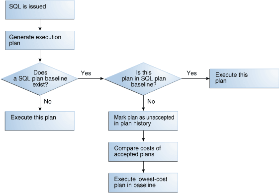

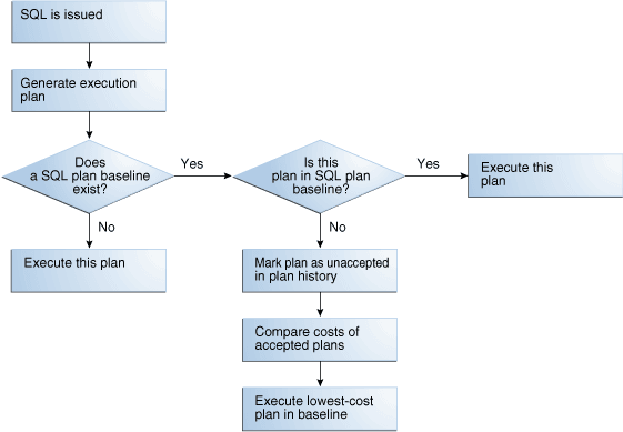

Plan Selection
SQL plan selection is the optimizer ability to detect plan changes based on stored plan history, and the use of SQL plan baselines to select plans to avoid potential performance regressions.
When the database performs a hard parse of a SQL statement, the optimizer generates a best-cost plan. By default, the optimizer then attempts to find a matching plan in the SQL plan baseline for the statement. If no plan baseline exists, then the database runs the statement with the best-cost plan.
If a plan baseline exists, then the optimizer behavior depends on whether the newly generated plan is in the plan baseline:
If the new plan is in the baseline, then the database executes the statement using the found plan.
If the new plan is not in the baseline, then the optimizer marks the newly generated plan as unaccepted and adds it to the plan history. Optimizer behavior depends on the contents of the plan baseline:

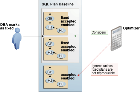

If fixed plans exist in the plan baseline, then the optimizer uses the fixed plan with the lowest cost.
If no fixed plans exist in the plan baseline, then the optimizer uses the baseline plan with the lowest cost.
If no reproducible plans exist in the plan baseline, which could happen if every plan in the baseline referred to a dropped index, then the optimizer uses the newly generated cost-based plan.
Figure 28-3 Decision Tree for SQL Plan Selection
Description of "Figure 28-3 Decision Tree for SQL Plan Selection"

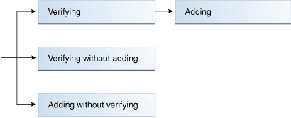

How Plan Evolution Works
Plan evolution involves both verifying and adding plans.
Specifically, plan evolution consists of the following distinct steps:
Verifying
The optimizer ensures that unaccepted plans perform at least as well as accepted plans in a SQL plan baseline (known as plan verification).
Adding
After the database has proved that unaccepted plans perform as well as accepted plans, the database adds the plans to the baseline.
In the standard case of plan evolution, the optimizer performs the preceding steps sequentially, so that a new plan is not usable by SQL plan management until the optimizer verifies plan performance relative to the SQL plan baseline. However, you can configure SQL plan management to perform one step without performing the other. The following graphic shows the possible paths for plan evolution.

Fixed Plans
A fixed plan is an accepted plan that is marked as preferred, so that the optimizer considers only the fixed plans in the baseline. Fixed plans influence the plan selection process of the optimizer.
Assume that three plans exist in the SQL plan baseline for a statement. You want the optimizer to give preferential treatment to only two of the plans. As shown in the following figure, you mark these two plans as fixed so that the optimizer uses only the best plan from these two, ignoring the other plans.
If new plans are added to a baseline that contains at least one enabled fixed plan, then the optimizer cannot use the new plans until you manually declare them as fixed.
