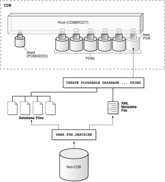

5.2.1 About Adopting a Non-CDB as a PDB Using a PDB Plugin
To manually adopt a non-CDB as a PDB, you generate an XML file that describes a non-CDB, and use the DBMS_PDB.DESCRIBE procedure. Afterward, plug in the non-CDB, just as you plug in an unplugged PDB.
If you choose not to use the Capture Replay method of automatically adopting and upgrading a non-CDB to a PDB, then you can use the manual procedure of describing the non-CDB, and then adopting the non-CDB to a PDB. Create the PDB with the CREATE PLUGGABLE DATABASE ... USING statement. When the non-CDB is plugged in to a CDB, it is a new PDB, but not usable until the data dictionary is converted, using the ORACLE_HOME/rdbms/admin/noncdb_to_pdb.sql script.
Figure 5-1 Plug In a Non-CDB Using the DBMS_PDB.DESCRIBE Procedure
Description of Figure 5-1 follows
Description of "Figure 5-1 Plug In a Non-CDB Using the DBMS_PDB.DESCRIBE Procedure"
