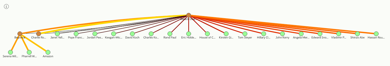

Hierarchical Layout¶
The hierarchical layout organizes the graph using a DAG (directed acyclic graph) system. It is especially suitable for DAGs and trees. It supports the following configurable properties:
ranker: Specifies the type of algorithm used to rank the vertices. Possible values: 'network-simplex', 'tight-tree', 'longest-path'.
Network Simplex: The network simplex algorithm assigns ranks to each vertex in the input graph and iteratively improves the ranking to reduce the length of edges.
- Tight Tree: Constructs a spanning tree with tight edges and adjust the ranks of the input vertex to achieve this. A tight edge is one that is has a length that matches its- minlenattribute.
Longest Path: Vertices are pushed to the lowest layer possible, leaving the bottom ranks wide and leaving edges longer than necessary.
rankDirection: Alignment of the ranked vertices. Possible values: 'UL' | 'UR' | 'DL' | 'DR' | 'TB' | 'BT' | 'LR' | 'RL' (where UL stands for Up-Left direction)
vertexSeparation: Sets the horizontal separation between the vertices.
edgeSeparation: Sets the horizontal separation between the edges.
rankSeparation: Sets the separation between two ranks(levels) in the graph.

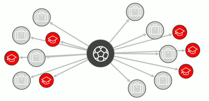

Radial Layout¶
The radial layout displays the dependency chain of a graph by using an outwards expanding tree structure. It can be especially useful if the graph data has a has a hierarchical structure and contains many children for each parent vertex. It has the following configurable properties:-
- spacing: Separation gap between neighboring vertices if they share the same parent vertex. If set to 0, no spacing will be applied.
