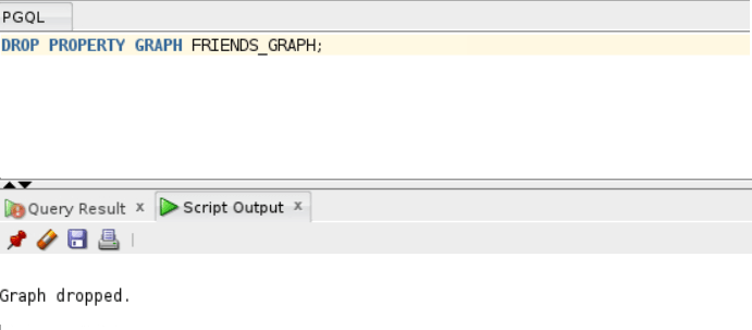

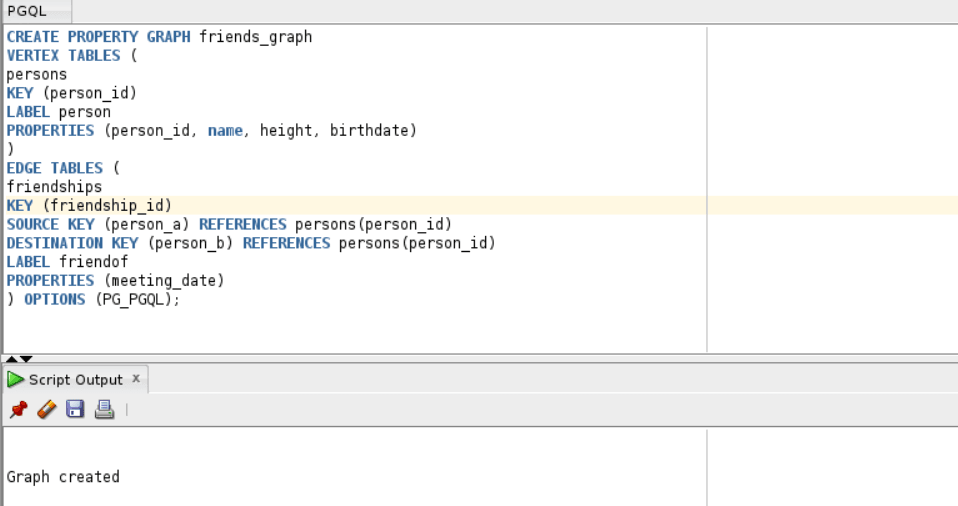

12.5.2 Using SQL Developer with PGQL Property Graphs
Using SQL Developer 23.1, you can view all the PGQL property graphs existing in your database schema by expanding PGQL Property Graphs under the Property Graph node in the Connections navigator.
Figure 12-3 PGQL Property Graphs in SQL Developer
Description of "Figure 12-3 PGQL Property Graphs in SQL Developer"
The following steps show a few examples for working with PGQL property graphs using SQL Developer.
