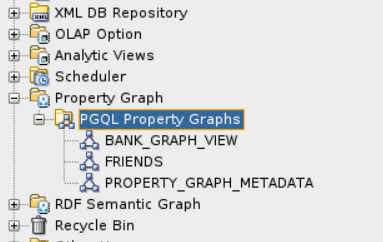

14.5.2 Using SQL Developer with PGQL Property Graphs
Starting from SQL Developer 23.1 or later, you can view all the PGQL property graphs existing in your database schema by expanding PGQL Property Graphs under the Property Graph node in the Connections navigator.
Figure 14-3 PGQL Property Graphs in SQL Developer
Description of Figure 14-3 follows
Description of "Figure 14-3 PGQL Property Graphs in SQL Developer"

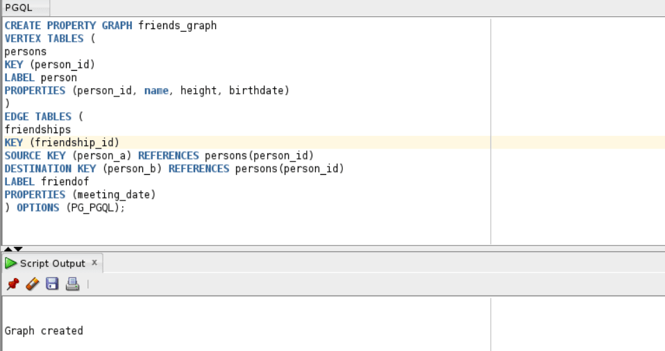

  2. Create a PGQL property graph by running a CREATE PROPERTY GRAPH statement in the PGQL Worksheet. For example:
    Figure 14-4 Create a PGQL property graph
    Description of Figure 14-4 follows
    Description of "Figure 14-4 Create a PGQL property graph"
    The result of the query execution is displayed in the bottom pane of the Editor. On successful query execution, you can right click and refresh the PGQL Property Graphs object to view the newly created graph under PGQL Property Graphs.

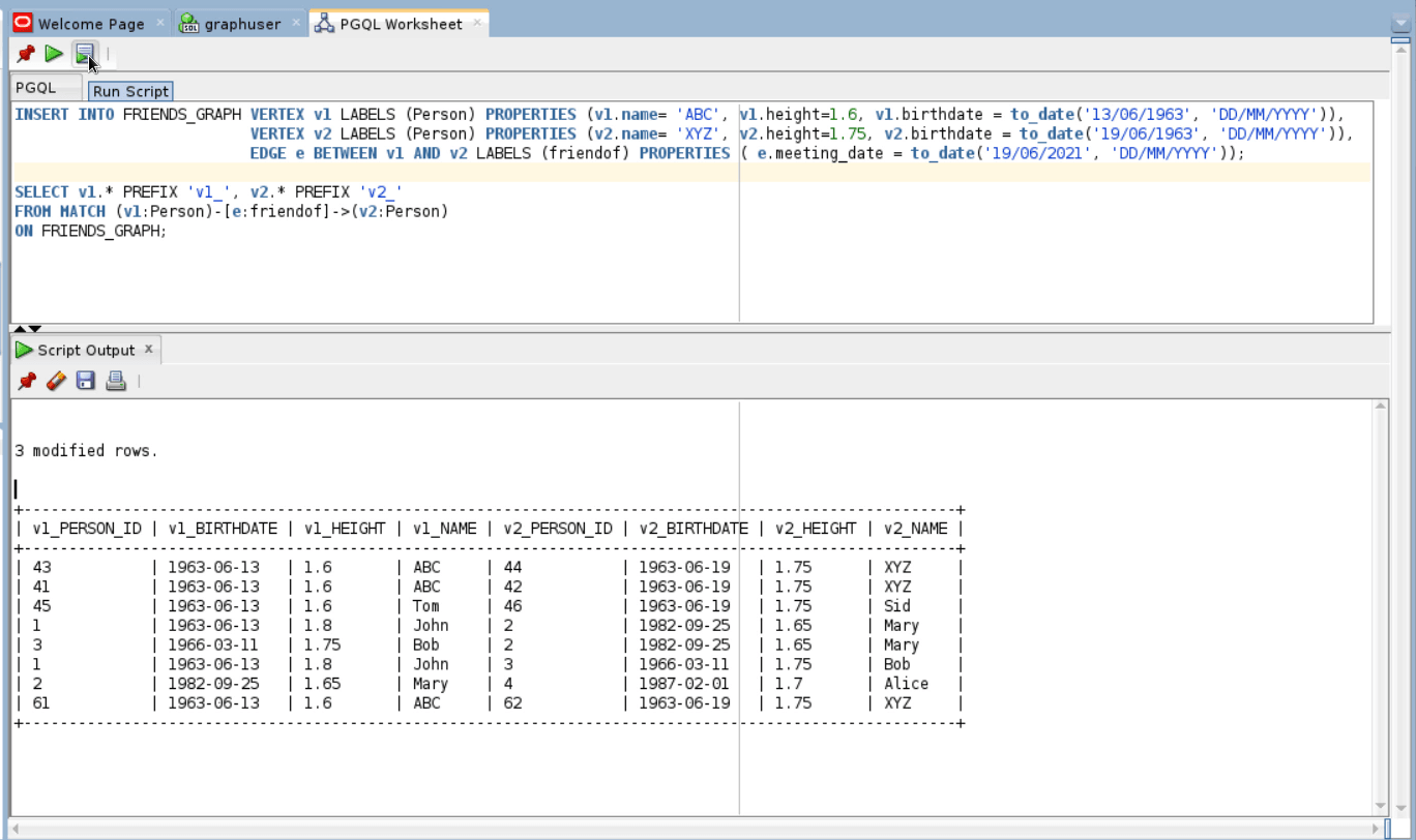

  4. Run one or more PGQL queries.
    For example, the following shows the execution of PGQL INSERT and SELECT queries:
    Figure 14-5 Running Multiple PGQL Queries
    Description of Figure 14-5 follows
    Description of "Figure 14-5 Running Multiple PGQL Queries"
    You can view the results in the Script Output tab.

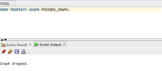

  5. Delete the PGQL property graph as shown:
    Figure 14-6 Dropping a PGQL Property Graph
    Description of Figure 14-6 follows
    Description of "Figure 14-6 Dropping a PGQL Property Graph"
    The graph is dropped.
