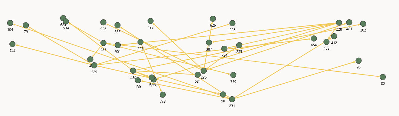

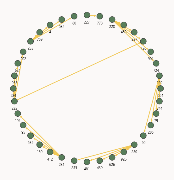

2.1.1 Circle Layout
The circle layout positions the graph vertices in a circle.
You can configure the spacing property to set the
the radius of the circle.
Parent topic: Layouts

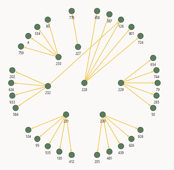

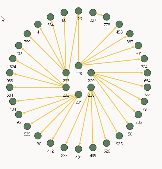

2.1.2 Concentric Layout
The concentric layout positions the graph vertices in concentric circles.
minimum spacing between the vertices. It is basically used for adjusting the
radius of the concentric circles.

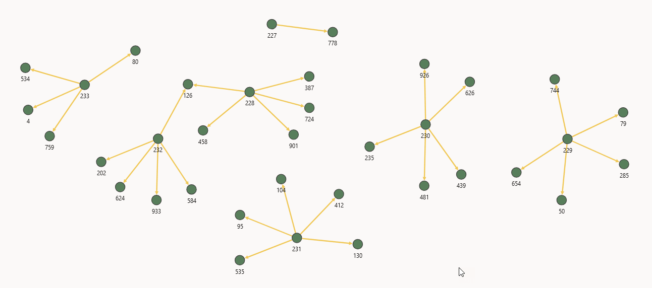

2.1.3 Force Layout
The force layout aims to create a visually appealing graph. It positions the graph vertices in the viewport so that all the edges are approximately equal in length and minimizes crossings between the edges.
The force layout can be used in one of the following modes:
- Standard mode: This is the default mode. In this
mode, all vertices of the graph gravitate towards each other equally
regardless of their label or property values.
Also, note that in densely populated graphs, the combination of vertex size and vertex count can generate strong repulsion forces in the force layout. This causes vertices to be pushed too far apart. You can correct this behavior by:
- Reducing the number of vertices displayed per page.
- Decreasing the size of vertices through styles.
- Lowering the
spacingproperty of the force layout. - Increasing the
velocityDecayproperty of the force layout.

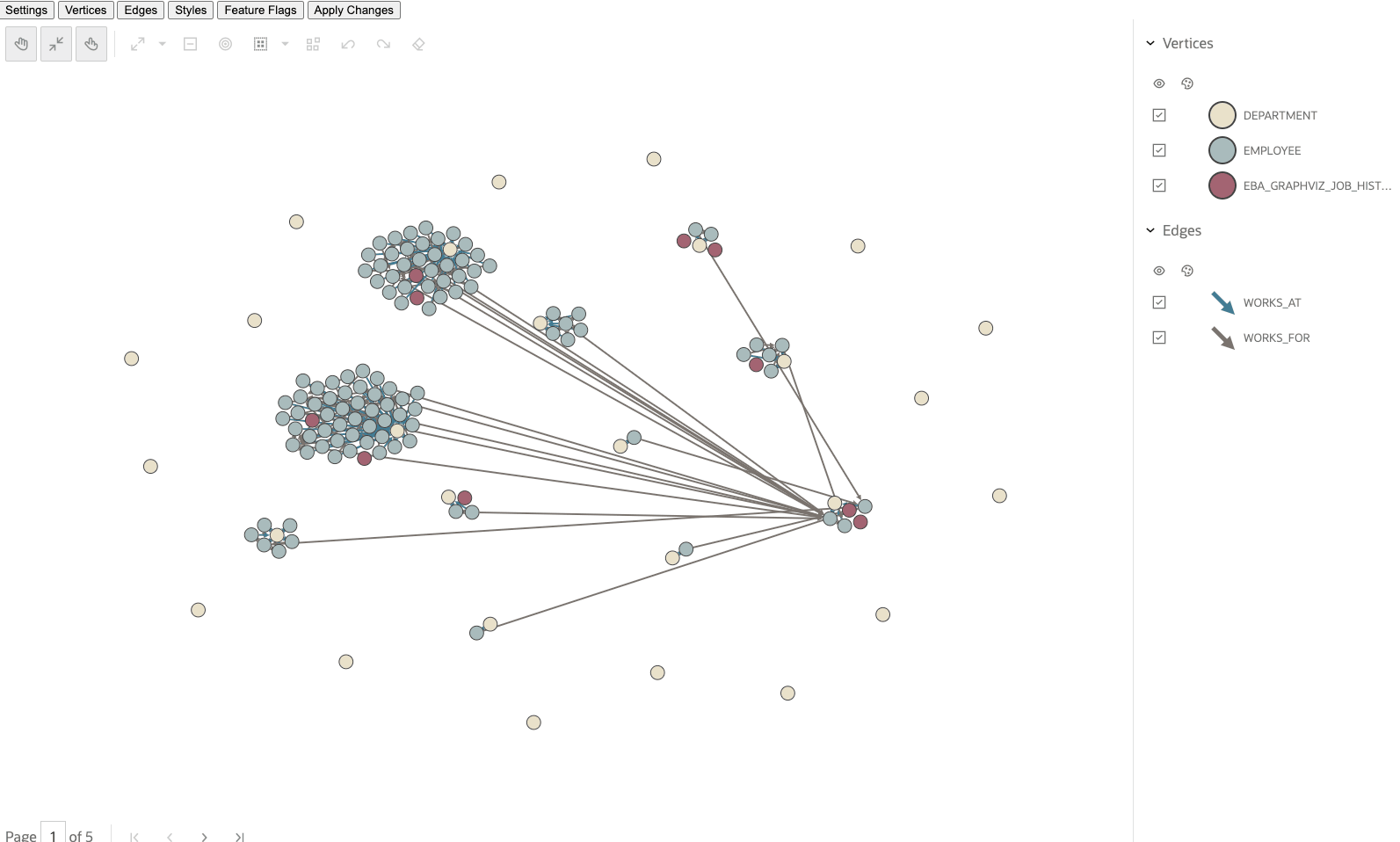

- Cluster
mode: You can activate the cluster mode by setting
"clusterEnabled": true. In this mode, vertices within the same cluster are attracted more strongly towards each other than those in different clusters, or no cluster. This is useful to visualize clusters or communities of vertices in the graph.You can define the following properties to configure the cluster layout. Note that you can use
clusterOptionsto specify the vertex property which defines the community or cluster membership of the vertices.edgeDistance: Sets every edge to the specified length. This can affect the padding between the vertices.vertexCharge: Influences the underlying forces (for example, to remain within the viewport, to push vertices away from each other). IfclusterEnabledistrue, then it influences the forces among clusters.velocityDecay: Determines the speed of the simulation.spacing: Determines the spacing between the vertices.clusterEnabled: Determines if a cluster based layout is enabled.clusterOptions: Related settings for cluster based layout only.clusterBy: By default, the cluster layout uses the first element invertex.labelsto form the cluster. Alternatively,clusterBycan also be set to the property name of a vertex. In such a case, the clusters will be formed based on the property value.hideUnclusteredVertices: Determines whether to display the vertices that do not belong to any cluster. Default isfalse.
The following shows an example for cluster layout:
Settings: { ... layout: { type: 'force', clusterEnabled: true, clusterOptions: { clusterBy: 'DEPARTMENT_ID', hideUnclusteredVertices: true } } }The example aims to create clusters based on
DEPARTMENT_ID. The corresponding visualization using cluster layout is as shown:

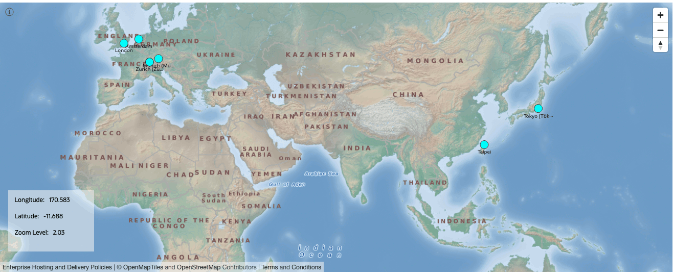

2.1.4 Geographical Layout
The geographical layout allows you to overlay the graph on a map.
However, this is provided that the latitude and longitude coordinates exist as graph properties on the graph's vertices.
You can configure this layout using the following properties:
appId: This accepts theapp idthat is used to fetch the maps fromhttp://maps.oracle.com/elocation. If a value is not provided, then a genericappIdwill be used.latitude: The vertex property to use for determining the latitude of a vertex.longitude: The vertex property to use for determining the longitude of a vertex.mapType: You can select the map type in map visualization or graph visualization settings. Alternatively, you can also provide your own sources and layers.The following map types are available:
- world_map_mb ("oracle-elocation")
- osm_positron (default)
- osm_bright
- osm_darkmatter
- custom_type
Note that the custom type has the following two additional fields:
sources: Provide your own sources to be used in the map in JSON format.Note: Due to security reasons, the
attributeproperty is separate from visualization.layers: Provide layers which you want to display on map in JSON elements array format. For example:[{ "id": "elocation-tiles", "type": "raster", "source": "oracle-elocation" }]
showInfo: Displays an info box in the visualizer (see Figure 2-5) that shows the Latitude and Longitude of the mouse position and the Zoom Level of the map. Supported values aretrueorfalse.showNavigation: Shows the navigation controls towards the top right region of the map.markers: Displays location markers on the map. This parameter accepts an array of objects as shown in the following format:interface MapMarker { longitude: number; latitude: number; content?: string; }

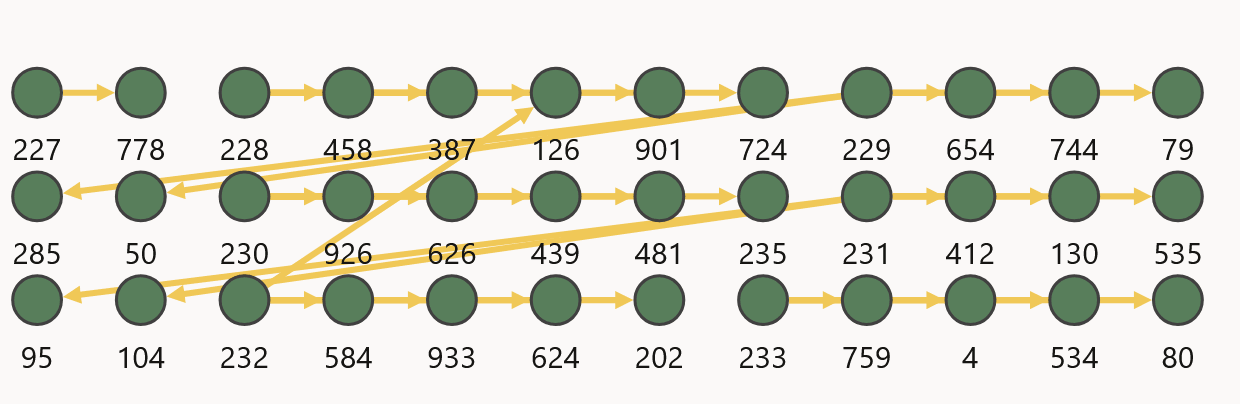

2.1.5 Grid Layout
The grid layout positions the graph vertices in a well-spaced grid.
space between the elements in the grid.

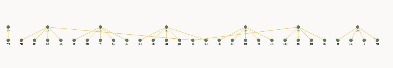

2.1.6 Hierarchical Layout
The hierarchical layout organizes the graph using Directed Acyclic Graph (DAG) system. It is especially suitable for DAGs and trees.
ranker: Specifies the type of algorithm used to rank the vertices.Supported algorithms are:
network-simplex: The Network Simplex algorithm assigns ranks to each vertex in the input graph and iteratively improves the ranking to reduce the length of the edges.tight-tree: The Tight Tree algorithm constructs a spanning tree with tight edges and adjust the ranks of the input vertex to achieve this. A tight edge is one that has a length that matches itsminlenattribute.longest-path: The Longest Path algorithm pushes the vertices to the lowest layer possible, leaving the bottom ranks wide and the edges longer than necessary.
rankDirection: Controls the alignment of the ranked vertices. Supported values are:UL(upper left),UR(upper-right direction),DL(down-left direction),DR(down-right direction),TB(top-to-bottom direction),BT(bottom-to-top direction),LR(left-to-right direction),RL(right-to-left direction).vertexSeparation: Sets the horizontal separation between the vertices.edgeSeparation: Sets the horizontal separation between the edges.rankSeparation: Sets the separation between two ranks(levels) in the graph.
