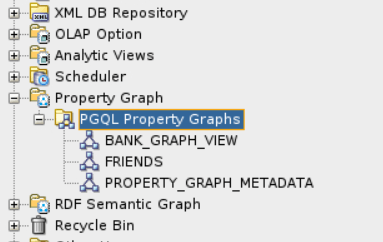

14.5.2 Using SQL Developer with PGQL Property Graphs
Starting from SQL Developer 23.1 or later, you can view all the PGQL property graphs existing in your database schema by expanding PGQL Property Graphs under the Property Graph node in the Connections navigator.
Figure 14-3 PGQL Property Graphs in SQL Developer
Description of "Figure 14-3 PGQL Property Graphs in SQL Developer"
