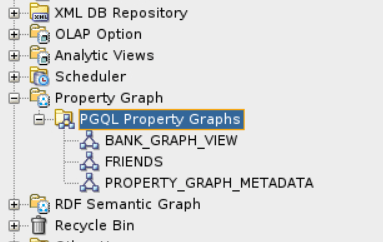

Starting from SQL Developer 23.1 or later, you can view all the PGQL property graphs existing in your database schema by expanding PGQL Property Graphs under the Property Graph node in the Connections navigator.

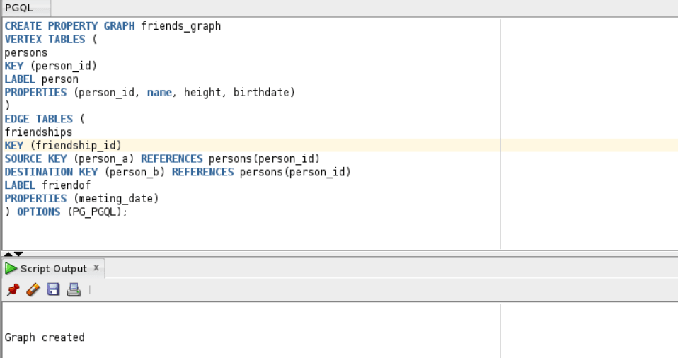

  2. Create a PGQL property graph by running a CREATE PROPERTY GRAPH statement in the PGQL Worksheet. For example:
    The result of the query execution is displayed in the bottom pane of the Editor. On successful query execution, you can right click and refresh the PGQL Property Graphs object to view the newly created graph under PGQL Property Graphs.

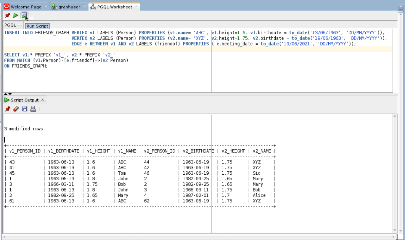

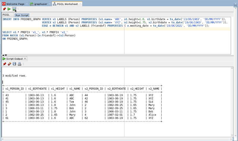

    For example, the following shows the execution of PGQL INSERT and SELECT queries:
    You can view the results in the Script Output tab.
