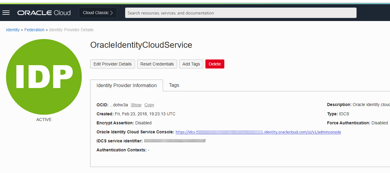

- Determining the IDCS Console URL
OCI tenancies include a default IDCS instance and you can obtain the IDCS console URL using the OCI console.
