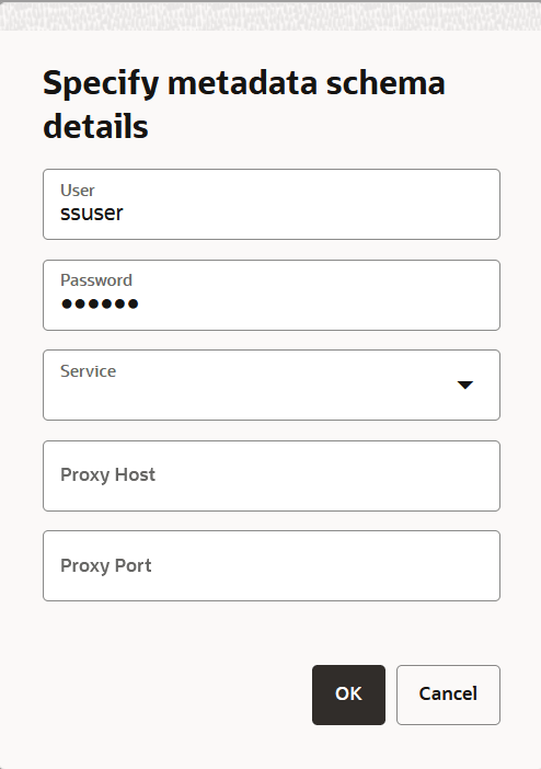

    • Oracle Autonomous Database
      The Upload wallet dialog opens.
      1. Drag and drop the wallet file (for your Autonomous AI Database instance) or click to upload the wallet from your system.
      2. Click OK.
        The Specify metadata schema details dialog opens as shown:
        Figure 2-3 Metadata Schema Connection to Autonomous AI Database
      3. Enter the Autonomous AI Database User name and the Password for the user.
      4. Select the appropriate Service from the drop-down list.
      5. Optionally, enter the Proxy Host and Proxy Port details.
      6. Click OK.
    The provided metadata schema details get stored in the sgtech_config.json file. The Getting Started page opens in the web application. See Using Oracle Spatial Studio to get started with Spatial Studio.

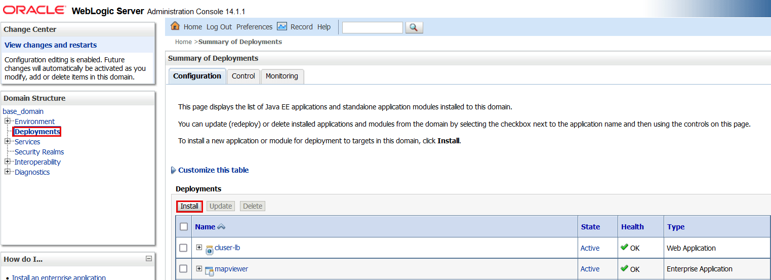

  1. Download the Studio EAR archive from Oracle Technical Resources or eDelivery, and save it to your local system.
  2. Log into the target WLS domain’s Admin console.
  3. Click the Deployments link on the left side.
  4. Click Install button under the Deployments section, as shown in the following figure (note that the exact contents may be different for your instance of WLS).
    Figure 2-4 WLS Admin Console for Deploying Spatial Studio
    Description of Figure 2-4 follows
    Description of "Figure 2-4 WLS Admin Console for Deploying Spatial Studio"
  5. On the next page, select the Spatial Studio EAR file downloaded previously, and install it as an application (not as a library).
  6. Click through the remaining steps, including selecting the proper target server. You should accept the default options in all cases unless you know exactly what you are doing. Finally, click Save to complete the deployment.
  7. If your WLS runs in production mode, you may need to activate the changes to ensure the deployment is activated.
  8. Make sure the newly deployed Spatial Studio application is marked Active; otherwise, you may need to explicitly start it from the WLS administrative console.
  9. Access the Studio application using your managed server’s URL with the /spatialstudio context root. For example: http://mycompany.com:7002/spatialstudio
