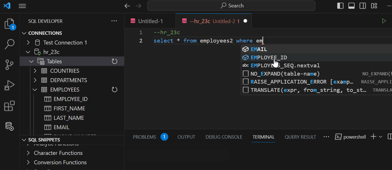

When you press Ctrl+Space, a context-sensitive popup window appears. This provides you with a list of possible completions at the insertion point that you can use to autocomplete code that you are editing. This list is based on the code context at the insertion point. To exit at any time, press Esc or continue typing.

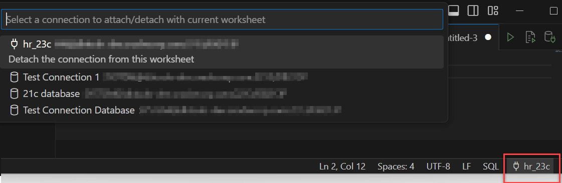

  • Attach/Detach Connection attaches a new connection or detaches the existing connection from the current worksheet.

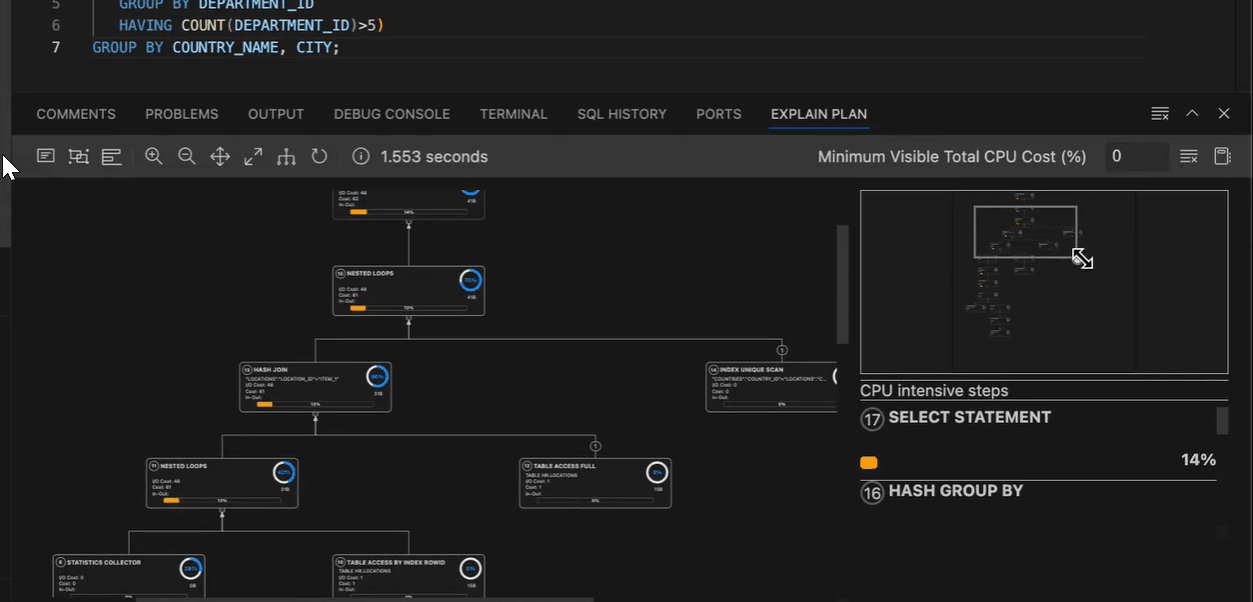

3.8.4 Explain Plan
The Execute Explain Plan icon generates the execution plan, which you can see by clicking the Explain Plan tab. The execution plan is the sequence of operations that will be performed to execute the statement.
The Explain Plain diagram view is a graphical representation of the contents of PLAN_TABLE, which is the default table for the results of the EXPLAIN PLAN statement.
By default, three levels of steps are visible in the diagram. You can use the +/- signs at the bottom of each step (available when the step has children) to expand or collapse. To view all steps in the diagram, use expand_all_icon Expand All in the toolbar.
The diagram also provides the following details:
  • Cardinality (number on the arrow to the parent step), which is the number of rows processed
  • Operation and options applied in that step
  • Execution order, which is the sequential number in the order of execution
  • Access predicates CPU cost in percentage (orange bar)
  • Total CPU cost for the step in percentage (blue circle)
  • Estimated I/O Cost, Bytes processed and Cost metrics
You see a brief description pop-up when you hover over any of the statistics in a step.
The icons in the toolbar are:
  • Text View: Displays the execution steps in a plain text format.
    For the Text View, you can select the level of detail displayed in explain plan by selecting the appropriate option in Using Preferences.
  • Diagram View: Displays the execution steps in a flowchart format.
  • Chart View: Displays data from PLAN_TABLE a flame graph.
  • Advanced View: Displays data from PLAN_TABLE in a mixed tabular/tree view.
  • Zoom In, Zoom Out: If a step is selected in the diagram, clicking the Zoom In icon ensures that it remains at the center of the screen.
  • Fit Screen: Fits the entire diagram in the visible area.
  • Actual Size: Sets the zoom factor to 1.
  • Expand All: Displays all steps in the diagram.
  • Reset Diagram: Resets the diagram to the initial status, that is, only three levels of steps are displayed.
  • Show Info: Shows the SELECT statement used by the Explain Plan functionality.
  • Min Visible Total CPU Cost(%): Defines the threshold to filter steps with total CPU cost equal or more than the provided value.
    Enter a value between 0 and 100. There is no filtering for 0.
  • Plan Notes: Displays the Explain Plan notes.
Properties
Double-click or press Enter on a selected step to open the Properties slider, which provides more information about that step. See PLAN_TABLE in Oracle Database Reference for a description of each property.
The Properties slider shows:
  • All information for that step extracted from PLAN_TABLE in a tabular format. Nulls are excluded.
    You can select JSON to view the properties in JSON format.
  • Information from OTHER_XML column of PLAN_TABLE.
    The information is displayed in JSON format.
Navigation
  • Press the Tab key to move through the steps in the execution order. The selected step has a blue border around it.
    To move in the reverse direction, press the Shift + Tab keys.
    If no step is selected, pressing the Tab key selects the step with execution number 1.
  • Depending on the zoom level, use horizontal and vertical scrollbars to view different parts of diagram.
    Click the left mouse button and hold it to pan the diagram around up and down.
    Use the scroll_icon icon at the bottom right to scroll to the top of the diagram.
Diagram Navigator
The Diagram Navigator is at the top right corner and represents a smaller copy of the diagram. The rectangle border allows zoom-in and zoom-out operations and moves to show different parts of the diagram.
The diagram navigator shows a list with steps having more than 1% CPU cost in descending order. Click a step in the list to navigate to the same step in the diagram, enabling you to see it in the context of the other steps.

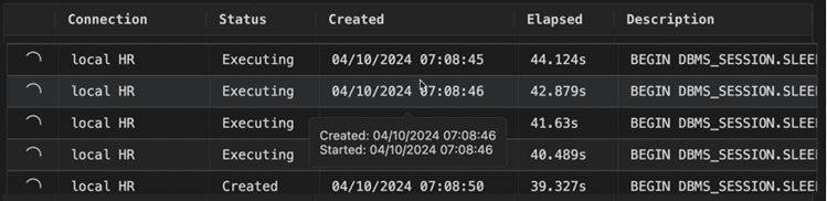

3.8.5 Task Monitor
This feature is available only if you are a user with a Database Administrator role.
The Task Monitor enables you to monitor the progress of all tasks in real time allowing you to effectively manage your time and resources. This is significantly useful for long-running tasks such as large data imports/exports, complex queries, running scripts, or database maintenance tasks. You can prioritize tasks based on their progress and estimated completion time.
The Task Monitor is a tab in the SQL worksheet output panel and displays a list of in-progress and unfinished tasks. Normally completed tasks disappear from the list.
When no tasks are running, the Task Monitor displays the Nothing to show message.
task monitor information
The information displayed for a task consists of the following:
  • Icon: Visually indicates the status of the task using icons.
  • Connection: Name of the connection.
  • Status: Current status of the task.
    • Waiting: The task is queued up to execute.
      This only happens if the Connections Sessions Sharing option in the Extensions Settings is set to OFF.
    • Created: The task is created and waiting to be executed.
    • Executing: The task is being executed.
    • Completed: The task is completed.
    • Error: An error occurred when executing the task.
  • Created: Timestamp of the task creation.
    When hovering over an entry, a popup is displayed with status-related timestamp information (such as Created, Started).
  • Elapsed: Depends on the status of the task. When the status is Created, Elapsed refers to the time taken to execute since creation. When the status is Executing, the Elapsed time then resets to calculate the time taken to execute the task.
  • Description: SQL statement or script that forms the task.
To cancel a task, right-click the respective task row and click Cancel.

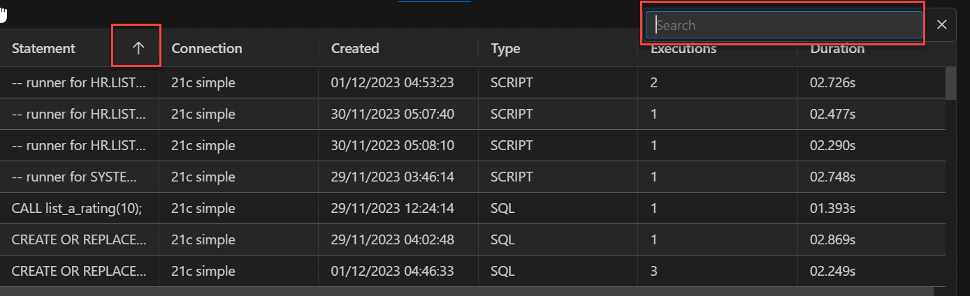

3.8.6 SQL History
You can click the SQL History tab in the lower right pane to view a list of SQL statements and scripts that you have executed, and optionally double-click one or more statements to have them either replace the statements currently on the SQL Worksheet or be added to the statements currently on the SQL Worksheet. The list is at first organized by date, and then by connection name.
The SQL history list will not contain any statement that can include a password. Such statements include (but are not necessarily limited to) CONNECT, ALTER USER, and CREATE DATABASE LINK.
You can control the maximum number of statements in the history by setting the SQL History Limit in Preferences.
When a SQL statement in the SQL History list is selected, it automatically opens the PL/SQL subprogram in the SQL Worksheet pane.
To sort the statements in the list, double-click the column header that you want to sort on and the statements are sorted in ascending order. Double-click the header again to sort in descending order. To remove sorting applied to the column, double-click the column header again.
To display the Search functionality, in the SQL History pane, press Ctrl+F (Cmd+F for MacOS).

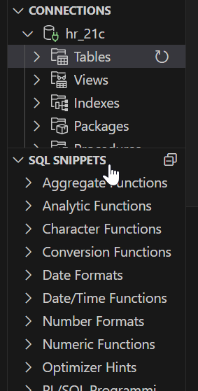

3.8.7 Using Snippets to Insert Code Fragments
Snippets are code fragments, such as SQL functions, Optimizer hints, and miscellaneous PL/SQL programming techniques. Some snippets are just syntax, and others are examples. You can insert and edit snippets when you are using the SQL Worksheet or creating or editing a PL/SQL function or procedure.
Snippets are displayed in the lower part of the Connections panel. Click the Expand icon to view all the available sinppets in each group (such as Aggregate Functions or Character Functions). In most cases, the fragments in each group do not represent all available objects in that logical grouping, or all formats and options of each fragment shown. For complete and detailed information, see the Oracle Database documentation.
To insert a snippet into your code in a SQL Worksheet or in a PL/SQL function or procedure, drag the snippet from the left bottom pane and drop it into the desired place in your code. Edit the syntax so that the SQL function is valid in the current context.
For example, you could type SELECT and then drag CONCAT(char1, char2) from the Character Functions group. Then, edit the CONCAT function syntax and type the rest of the statement, such as in the following:
SELECT CONCAT(title, ' is a book in the library.') FROM books;
