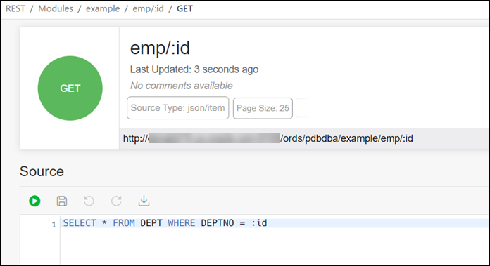

The Handler HTTP method page has two major sections:
A code editor for executing the SQL or PL/SQL source code that was defined in the resource handler. You can execute the code, save, undo, redo, download and clear output.
A section for managing parameters required for running the HTTP method.
By default, the parameters are displayed in grid view. The attributes displayed on a parameter in card view are shown in the following figure.
