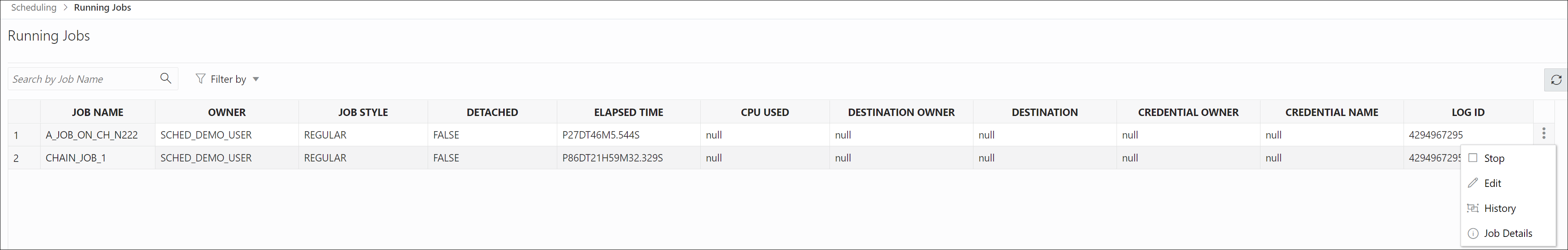

9.2.2 Running
The Running page displays the list of currently running jobs. The following commands are available: Stop, Edit, History, Job Details.
