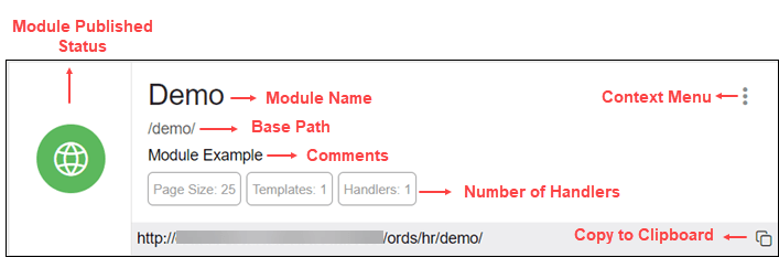

The module attributes displayed by default in card view are shown in the following figure.
The module status can be published or unpublished. If the status is unpublished, the icon is displayed in a red color.

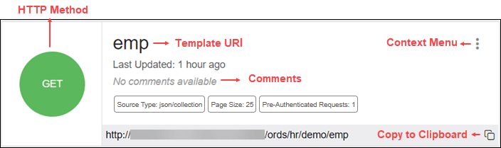

The templates attributes displayed by default in card view are shown in the following figure.
Click the template name in card view to go to the Handlers page. You can also navigate to the Handlers page through the context menu.

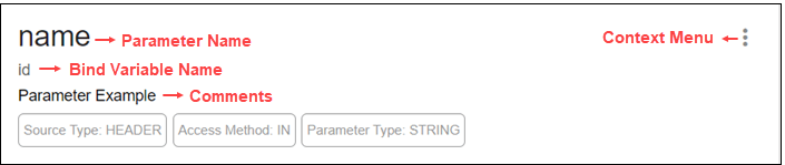

By default, the parameters are displayed in grid view. The attributes displayed on a parameter in card view are shown in the following figure.
